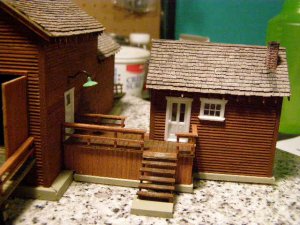

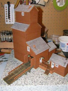

Hi guys, I'm relitively new to this hobby but I'd like to show you my grain elevator, I started with a wood kit from Kanamodel and full size copys of blue prints I aquired from Saskatchewan Wheat Pool (35,000bu) and United Grain Growers (30,000bu). added 1.5 inches to the height of the kit and fabricated a proper 2 story Drive shed as all elevators around here have Grain cleaners. (carefull some were added later they usually have a visible seam outside) i'm modeling a local line c1928
Heres an original British America elevator, later National and finaly a seed company. hope this isn't too many pictures, I have to make the office and walkway yet and roofing and hang some doors i lighted the inside with some small incandecent bulbs as Led lights don't throw a nice natural color.

I'm shooting for nearly new as the line was built in 1925 and i'm modeling 1928,,,, but what can i guy do to make those paper shake shingles on a roll look a bit better, i thought about oiling them like i did the inside.

Really nice. I like the fact that you're building it 'as new' I would figure that the maintenance on a grain elevator when it was in constant service would be pretty good considering it was the source of revenue for many farms around.
The machinery is a nice touch as well.

Hi Chad For those shingles why don't you go with real cedar like I did on my elevator. They look really good on these old structures. Heres a few pics Ron
If the paper shake shingles have grooves you could try sealing the paint on a test piece and then do a wipe-on/wipe-off of a darker color. Let it dry and then seal the new darker paint. (Use to work for me on deck planks created with a single piece of balsa, blunt scribe and ruler.)

Hi Chad. Just wanted to say the elevator looks great.The first time I looked at your post the prototypes were the only pics that came up. Is that elevator in Tisdale or one of the neighbouring communities.There aren't to many left here in Manitoba although in Inglis Manitoba they have restored three and made them into an attraction there.Not that far from you if you are interested.For the paper shingles if you paint them light gray and then give them a very thin wash of india ink diluted with alchohol(1 part ink to 50 parts alchohol) it will give them a nice weathered look. Ron
