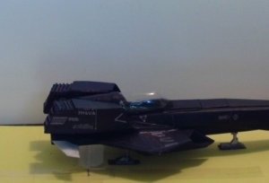

Thanks Rhaven, for the comments.

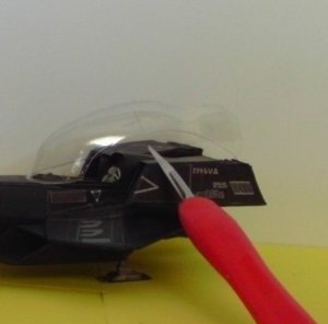

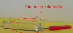

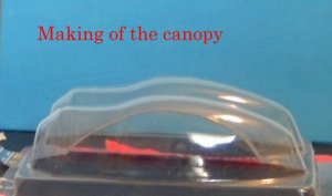

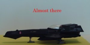

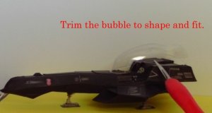

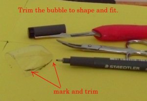

Some more updates on that canopy and stuff. As mentioned before, You have two tries with the double bubble. Just keep trimming the edges carefully and constantly checking for the fit. Next posting will be on the placement and gluing of the canopy with regular white glue. I used super glue in the past, but it had a tendency to glaze and fog the canopy. Now I use my sticky label technique and it works without the danger of the super glue sticking to your fingers and heavens forbid, finger to model. See you around in the next posting.:wave::wave::wave::wave:

More on the canopy and stuff.
That last pic is out of sequence, it should have been the second pic this posting.

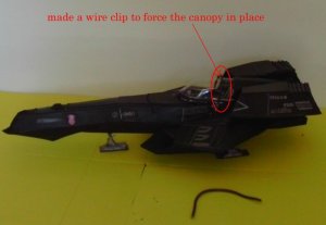

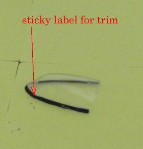

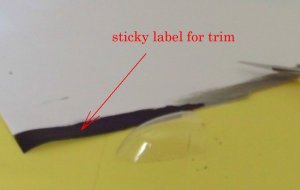

I took the avery labels and colored a section that I will cut into thin strips to place around the rim of the canopy. The reason for this, is that this way the trim sticks to the acetate and the glue will have better adhesion. Instead of gluing acetate to paper, you have paper to paper adhesion.
The Stealthstar is just about done. I am working on the extras and did a test plan sheet that came out with better details and is only 225kb, which is uploadable. Working on that mule and the tow bar. This one of those times that I am actually doing two projects at the same time and not running into too many conflicts. Plus I am posting the builds on another site (PM) as well.:wave::wave::wave:

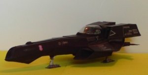

As mentioned a while back in one of my builds, if just one person learns something from my build, then it is all worth it.

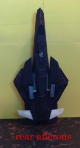

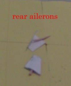

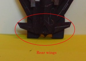

The final touch are the rear wings.
Well this bird is done, now to work on the display to show it off.:wave::wave::wave:

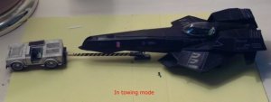

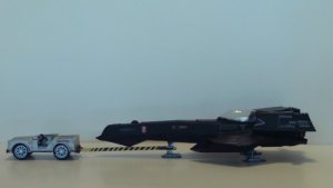

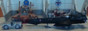

Here are a few add ons for this model. The BSG tow mule. The plans are in the download section under the Battle Star Galactica sub Category. Enjoy, I will start the build thread on the mule shortly.:wave::wave::wave:
