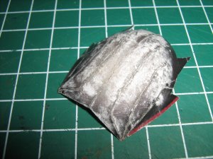

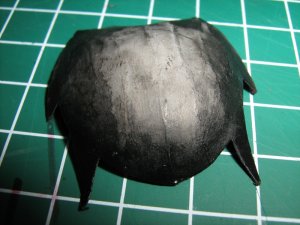

I started with the canopy bubble. I edge glued the thing together with tacky craft glue and when dry, strengthened the joints with CA glue.
I really was not happy with the outcome, so I sanded all the joints with 1000 grit glasspaper. This of cause removed most of the print.......
So, repair time.... I coated the whole sanded surface with white watercolour, especially in the middle and blended it outward. Once this had dried, I used many coats of watery but pigment rich black water colour. I paint the middle of the dome and let gravity pull the pigment naturally downwards towards the edges of the dome. In the pic you can see the result. It needs many more coats yet to get it right....

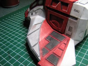

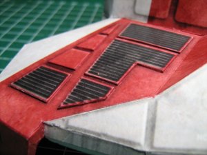

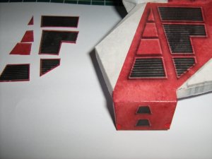

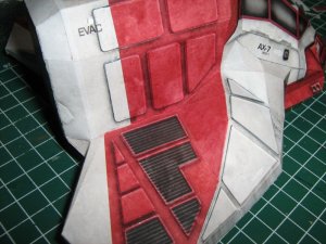

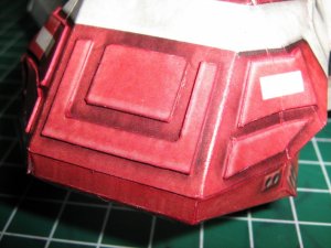

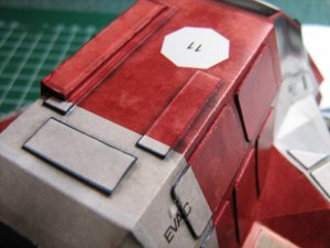

Even though Revell-Fans texturing is superb, I wanted to enhance the model a bit more, so I decided that I was going to detail up the surfaces of the model with armour paneling... I should of done it when everything was still in the flat, but it is still workable this way. As I tend to print 2 copies of a model, I laminated the second spare 160gsm printed stock to 200gsm stock, to give the desired thickness. I cut out the panels and then glued them on.
I only started this bit tonight, but will do some more.... But I really like the effect so far!! :mrgreen:

Very nice work on the armor panels kinda the effect I am going to use soon. first three parts pages printed and I'm outta ink Razza Frazzin :-(
11,005
7,528
You are doing a FAN(FRAKKING)TASTIC job on this build.
I like how you are taking the texturing to the next level.
I plan on doing the same when I rebuild mine.
Keep up the GREAT work.

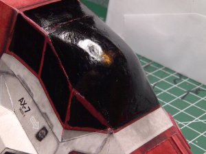

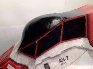

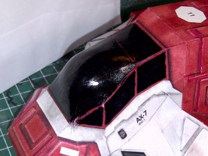

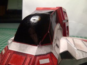

I got back to the canopy, as a start. I wasn't happy with the result of my colouring or finish of the previous attempt. And then I read the MOM for mcusanelli's finished Raptor, and I liked the finish he achieved on his canopy. So I decided to give his finish a try.
Using strips of sticky labels on the inside, I fitted the canopy in position and ca glued all the joints nice and snug.
I gave the whole canopy various good soakings in ca glue and let it dry thoroughly. I then gave it a good sanding with 1000 grit glasspaper.
Next, I coloured the glazing with a black permanent marker. I wasnt too worried about black ink on the frames as I am raising the detail of the frames later.
The black ink is semi glossy, so it helps to show up the imperfections in the finish. It is just a case of colour, fill, sand, colour, fill, sand,... until the surface is as smooth as possible. I used gap-filling (gel) ca glue to fill small holes and imperfections.
Once I got it to a semi decent finish, I very carefully gave the canopy a light coat of Future, or, Pledge Parket Plus, as it is called here in Holland.
I have had a lot of experience with this product and its multitude of uses, but I was a little concerned with screwing the finish on my Raptor, but apart from a small run that stained the finish, I had no problems.
The pics below show the result after 2 coats.
I am still going to do another colour, (fill) and sand routine, and then give it a final 3 or 4 coats of Future. Once that has hardenen well, I will buff it up with MicroMesh polishing papers to dull the gloss to a more fitting lustre.
I'll be working on it over the next few evenings, so will keep you posted.
