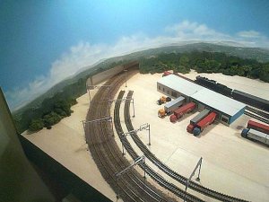

I wanted to disguise the hole with a highway overpass.
This would achieve two things. Allow road vehicle access to the industrial area on this module as well as cover the hole.
I have started building a highway overpass using balsa wood abutments and bridge supports (these will be clad with other material when the job is finished).
Here's the start:-

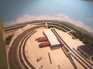

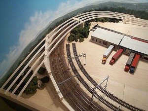

This bridge has to be "purpose-built" for the location as it has to curve to mate with my curved backdrop.
I needed a material I could curve sideways and downwards at the same time (to form the incline on one side).
Balsa strips are ideal for this.
This photo shows balsa strips bent and pinned in place while my bridge design comes together "on the fly". he heh

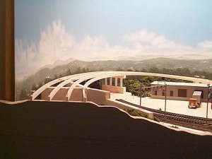

Well, after 30 minutes, this is as far as I have got.
But now I can at least see the "skeleton" of the desired final product. This is where balsa wood is just the most convenient modelling material. It is SO-O-O easy to work with (cut, glue, pin).
You can see the aeromodellers' "T" pins holding things together in this photo:-

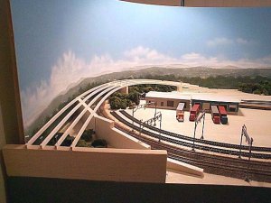

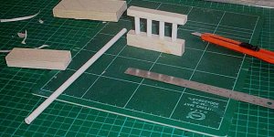

A quick test fit inder the bridge deck.
I have carved the block of balsa in the foreground to a landscape profile and painted it to match the rest of the fascia.
I have also realigned the road to a continuous curve through and off the bridge.

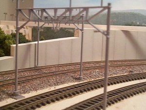

Some of the concrete has been "poured".
I used some mid-grey "German Board" (available from art stores) to cover the grain of the balsa and represent the "concrete" bridge abutments. I drew lines with a 2B pencil (then smudged a little with my finger) to represent the "pour" lines in the concrete.

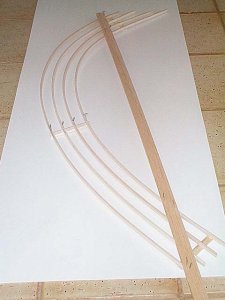

In this photo I have laid my bridge deck down onto a sheet of styrene so I can trace the curve of the bridge onto the plastic.
(You will note the four strips of balsa which form the bridge deck have been held in the correct curve by a batton of balsa temporarily pinned across them)
Next task will be to cut out the road section from the styrene sheet and paint it grey.
