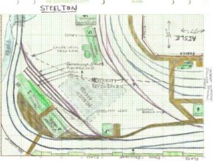

Here is a photocopy example of the above idea.It is 1 layer.several can be done as i will explain below.
This is a Corner area of my plan measuring 50" x 36".
It includes all trackage running through the area including mainline,Steelton,Wrenshall Branch,Steelton interchange track,Mill tracks,several buildings with notes naming tracks etc.
Additional notes can be made on a photocopy reduced somewhat to give you a side margin and you can then indicate Wiring particulars,Switch type,operation,Business names Items wanted lists,notes on superdetailing needs,weathering needs etc etc for organization ,maintenance and operating purposes.
The amount of information that can be included is endless just by Layering the photocopies.
Everything you could possibly ever need to know about this particular 50 x 36" area can be at your fingertips in a color filed 3 ring binder.
You could have 4, 8 ,15 area's or even more.
The area's can be seperated By colored dividers and the layers organized within the dividers,or Each layer type could be kept together and types seperated by color code.
Want to know about your wiring?? Flip to wiring layer division and go directly to section getting the information required.
In this manner you can have many sections partially developed and never lose track of where you are at and what improvements you would like to make.Include a pocket folder for each section and you can even keep your quickly scribbled notes and idea's for each section.
Now we are organized :)
