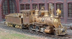

My first brass piece is all the above, cantankerous, ornery, corroded....but I wouldn't have it any other way. It's a United/PFM C&S 2-6-0 Mogul in HOn3 that I was given for helping settle a fellow modeler's estate.
My most desirable ones would be the tiny teakettle steamers like Mich-Cal #2 or any of the tee boiler climaxes and shays that came out in the early 70s. At the other end would be the 4-8-8-8-4 Virginian triplex complete with a can motor on each engine put out by Oriental in the early 80s. SIGH...I can dream...:)

Thanks, Larry. I amm looking to remotor it with a flywheel in the tender, it has a similar drive train to AHM/Rivarossi 4-4-0 Americans.

Zane isn't going to lead you astray, if that's what it's worth, that's what he'll charge. Sweet looking turbine and you're not going to find a whole lot of custom painted brass for that price. Ultimately, it's your money...is it what you want? Are you looking for a model desirable to you or a good investment unit? While my C&S steamer isn't what I would've normally gone for, it is a gift of trust and gratitude worth far more to me than the $275 or so that it would sell for now. On a retail level, as an investment brass issue, it's gained a good bit on it's original $59.95 issue price. On the other hand, you can probably cop the Lionel turbine with DCC, tender and sound for about the same price on a good day.

A brass loco like that one is going to need 22-24" radius curves right up front so keep that in mind. For custom road names I'd stick with plastic or undecorated brass as they do not retain their value as much as if they were painted for their prototype road. I fully intend to paint the mogul in whatever scheme was appropriate for that particular model. DCC in an older brass loco is going to be a bit of work---not impossible---but know that up front as well, probably along the lines of an old Rivarossi. More than likely you'll have to remotor it as well because older open frame motors draw serious amps, enough to smoke the most resilient decoders out there.:thumb:
