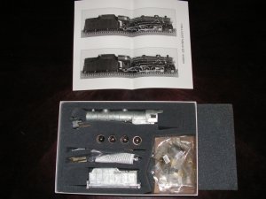

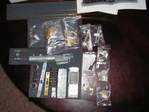

The first few pics are in...
I don't know that I will be able to start building before Monday, but here is what came in the box...
Strike that... It would appear that I can not upload photos. I keep getting a database error.
I will try again in a little bit.
