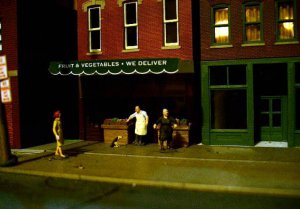

Excellent photo and modelling Val, could resist playing around with one of your photo's. Hope you don't mind.

Mind?!! Mind??? No, I certainly don't mind Shamus. You are the master photographer and modeller after all. It looks much more like the time period now. Cool!

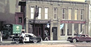

Got the new camera up and running. Here is a shot of the loading area at Thomas Manufacturing. I scratchbuilt the dock and sliding door out of plastic (using a left over grab iron for the door handle) and the freight elevator door is made of stripwood stained with some old stain I had kicking around. At one time I lived in an old warehouse and I have a real soft spot for those old wooden freight elevator doors.
