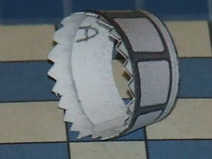

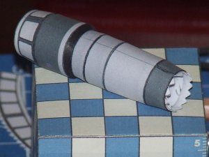

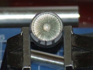

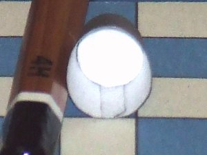

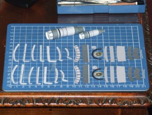

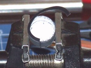

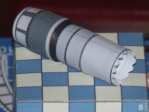

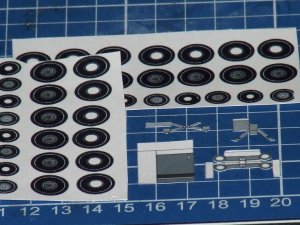

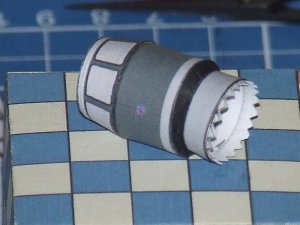

Can you guys remember these items that i started to make for the Boeing 707 {see attachments} Whilst still in a builders block with the Boeing B-52, i decided to carry on and try and finish the B-707. I have been trying to get hold of the original designer of this model {Bob B.} to try and get his permission to do a re-paint of his model - does anyone know of his where-abouts or have some contact details i could use to get in touch with him ? I would be most grateful if someone could help. The Original model can be found here:
http://jleslie48.com/ I got in contact with John, and he couldn't get hold of Bob B. Thanks in advance guys.

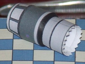

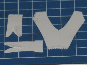

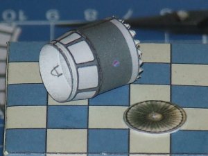

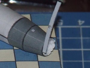

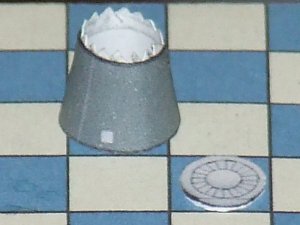

B-707 continued here again...

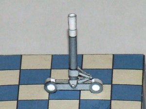

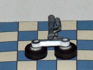

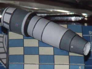

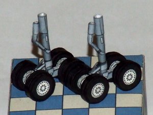

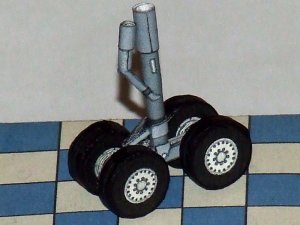

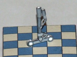

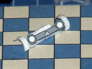

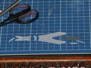

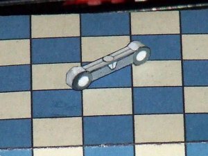

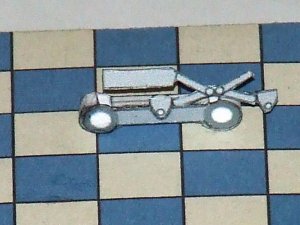

And on to the Undercarriage {main} Front cart started but not finished yet !

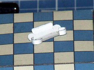

and some more piccys...

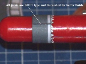

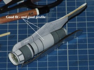

Wow, that's really excellent Pete!! On those Butt Joints, did you angle them? They look great! The rest of the model is just fantastic and she's going to be a proper Boeing 707 for sure!!
peter taft
Jan 15, 2010
879
I did indeed John, makes for a far better profile and all skins follow around at the correct angle :thumb:

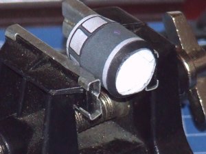

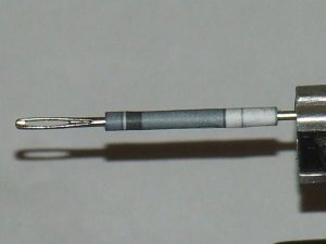

Tool question

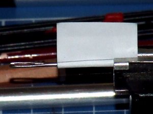

Peter,

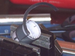

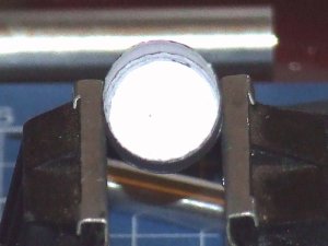

In post 5 above you have a couple pictures where you are using a sewing needle to roll the tubes for the landing gear. What is the metal piece holding the needle? Could you give us some more shots or explanation of how you make those small tubes?
Great work so far. Building one of these airliners is getting close to the top of my to-do list. Can't be more than a few years away now :) but lots of models need little tubes.

Thanks for the kind words Steve, and GREAT to see you are still working with the paper - your F1 car is most excellent :thumb: I don't have any shots of the item holding the needle - i will try and get some done for you. The item is a small plastic vice with aluminium jaws. It has a lever on one side which you pull down to make the vice suck down onto a smooth surface. I can't remember where i got mine from - i've had this for as long as i can remember, but i think a good hobby store should have them, and they're not expensive {at least they were cheap when i got mine} i wouldn't be without it - i use it for holding small circuit boards {there are slots in the alu jaws for this purpose} infact..... i think i got this from Tandy {Radio Shack} For small tubes, i first get a curl into the paper, run it up a flat hard surface or on the palm of my hand. Once the curl begins, i attach one end to the needle with a tiny piece of low tack tape {too much, and you wont get the tube off the needle. } I turn the paper a little at a time adding small amounts of glue as i go. When i reach the end of the roll i sit and hold it till it's dry enough not to spring open - you could use a peg to hold it if you wanted to. Once totally dry, i burnish the end {press along the seem with a smooth small spoon or similar} after that - slide the tube off the needle.... job done :thumb: Hope this helps Steve. The 707 is almost complete and will make her appearance here very VERY soon - camera willing.

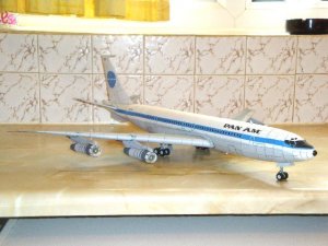

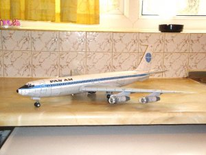

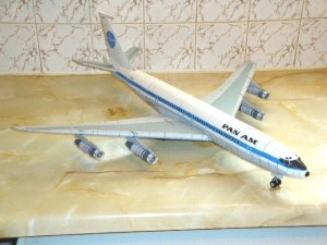

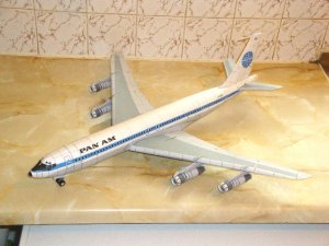

O.k.... the Boeing 707 is now complete :) A resume of what went into this build.
1} Engines/Pylons/Undercarriage built {a while back} using GOOD quality cardstock {Tesco Executive Presentation Card @ 160gsm} This is my usual brand that i can safely say is THE best i have ever used, and i used this for all my previous builds.
2} The rest of the model {skins} Forced to use CHEAP cardstock from a pound shop {25 sheets for £1} No weight given on the packet, but under the 160gsm. The card is o.k'ish, but the problem isn't with the printing on to it, it's when you want to glue it up ! the glue re-activates the printed ink surface, i know you expect this to a point on most cardstock, but this was a game for a laugh.... also, when putting the formers and bulkheads in, you could start to see a brownish mark appear on the other side after a while, this mark doesn't go away. A huge lesson learnt here :rolleyes: I have one positive thing to say about this cheap cardstock ! It didn't make my skin condition flare up once....ummm makes me wonder what they left out ? :confused:
3} All Bulkheads/formers/spars made from VERY stiff 2mm card - knife blunting card for sure - but hey.... they didn't have any issue with keeping straight and FLAT ;)

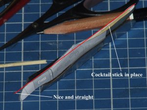

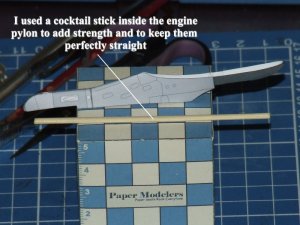

4} Added cocktail sticks to insides of engine Pylons to keep them straight and true - i am SO glad i did this !
I forgot to put the scale cube in the shots - so here's the dimentions:
Please remember that i up-scaled this model from 1:72 to 1:48
Length = 20" {nose to tail} Width {wingspan} 20" Height {to tip of vertical tail} 6.5" so a fairly large model at this scale.
Thanks to: Bob Bendorf for this marvellous design. Rob Tauxe and Don Boose for helping with emails and contact with Bob - MUCH appreciated guys :) Thanks for following this thread, and i hope the last few pictures will have been worth it for you. I enjoyed building this model for sure - i hope you did too.
