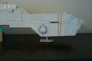

It's a good thing I took images of the Thunderhawk in grey because you can't see any detail with it painted black.
This weekend will see the beginning of the paint process and i still haven't come to grips with the ball turrets.
That shouldn't be a problem although my camera still cannot seem to focus and that is quite serious. I'd really hate to have to replace my trusty Kodak DC290. Anyone have any suggestions?

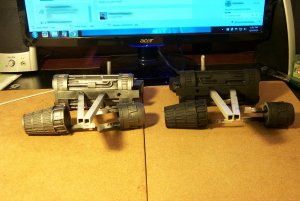

Instant Silvering and Patina:
Anything that can save me time and give good results is aces in my book; here is a simple way to give a metallic luster to your bare metal surfaces...........
This might not be up to standard for PRO painters but for a mere mortal such as me it yields adequate results and it's fast, did I mention it was fast? and it's economical; I probably won't be able to use all the aluminum powder I have; '3 ounces', in my lifetime.
The entire engine and the wing root used just the powder that was stuck to the lid rim of the jar.
First I applied some really cheap flat black aerosol paint (Walmart generic $0.99 cents @ standard spray can)and let dry overnight.
Then with index finger I applied and rubbed in a bit of the powder and brushed it smooth and into the crevasses with a brush which took all of a minute or two to do the cowl and exhaust. and that's it; no drying time you're finished.
A couple more minutes to do the engine body......
Then I took the pictures.

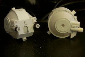

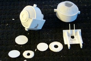

This Time We're Serious:

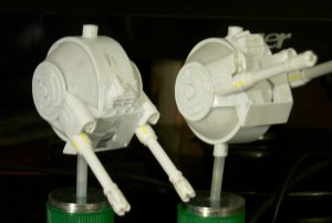

Okay time to separate the men from the boys...... I've yet to find an easy way to replicate spheres but it seems I never learn to stop trying. This latest fiasco involved substituting a pingpong ball for nittygritty hard work and planning and as per usual it didn't work so back to square one. The saving grace of employing the P.P.ball is I did manage to get a viable scale for the ball turret which seems to be right for a vehicle of this size.
To recap, what I am attempting to do is make a fully operational (as far as movement potential; Egad!) turret with guns that depress and elevate as a real ball turret would do so using the p.p.ball as a size guide I figure a centimeter would be correct for the swiveling elevation/depression cycle and the standard rim will suffice for the rotation.
This will hopefully be made clearer in the subsequent posts......... or fail utter-ably whichever the case may be.
It's all new ground to me, this one.
Oh, and BTW the new cockpit seats are to the background right; just saying............

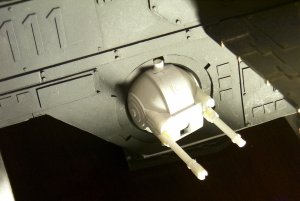

Flogging a Dead Horse:
I'm forging ahead with the original ball turrets in spite of designing a set after the FW version so some of my work is original at least.
I don't know if the FW turret guns are elevate-able but mine are so therein lies the difference in appearance.

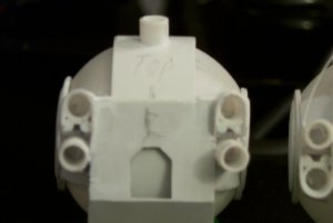

Fuzzy Images
You wouldn't think I have a SOTArt Cannon digital SLR camera judging by these fuzzy images but I still prefer my 20 year old Kodak 290 for some reason...
Anyway the ball turrets are proceeding apace shown here in different stages of completion.
Any questions you have on what I am doing or how I am doing it I'll be glad to answer.... 5.jpg
Hmmm, the above image doesn't bear close inspection; left gun sight is a bit cattywampus....
Reactions: Rhaven Blaack
12,563
8,059
You could have filled the Ping Pong balls with two part Epoxy and kept moving them till they dried. That would have given them strength to work with. Whatever you do seems to work, so soldier on!! :)

Thanks for the reply. The durability of the balls was not an issue and the curing heat generated might have distorted the balls......

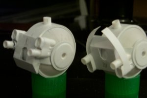

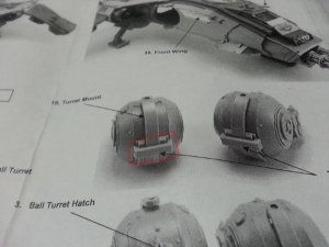

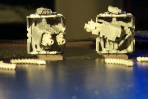

What Am I Missing?
For the life of me I cannot figure out how these guns can elevate. With the rectangular view port and mount plate it seems that the gun mount shield (Plate between the guns) when the guns are elevated will interfere with the viewport and vise versa. If the side hemispheres only rotate upward then the viewport is not looking where the guns aim plus the entry hatch miss aligns. Or alternately it's just another FW bollock-up in the design department and it just looks good and can't function.
Anyway here's mine with out detail as yet but fully functional at least regarding movement.
the back of the turret and how it moves vertically.
Best I Can Do:
Try as I might this is the best range of elevation I can come up with using ping pong balls.
The front view is satisfactory so now for the detail:

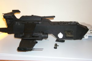

Okay with these final bits of fluff the exterior of the T'hawk is just about done. I daresay there might just be a couple of negligible items such as Turbo laser strut cradles et cetera but nothing that would preclude my painting the exterior. This has been a good year for me as most of my long term projects have reached fruition.
I decided to keep the ping-pong ball turrets as they are and add the view port and paraphernalia to the elevation race plate. The upper end of the elevation is in need of restriction so the canard wings won't get shot off in the heat of battle.
Now all needs be done is the interior of the cockpit and installing the interior of the forward cargo bay.
No I haven't decided whether to add the auto-fire dual bolters on either side of the nose abaft the front cargo door.

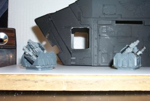

Some Dumb Disney Movie:
A pair of Wall-E esque bitz altered twin bolters round out the forward armament slated for the Thunderhawk.
I was scrounging around in my bitz box and came up with enough material to make my own version of the FW T'hawk bolter armament.
Now whether I actually cut the holes in the fuselage to accommodate these hefty trainable beauties remains to be seen.

You have to use less hardener agent, and it takes longer but you get a stronger ball. It is true that heat can makes balls drop. :)
11,004
7,527
The amount of time, effort and work that you are putting into the details of this project is paying off! The ball turrets look FANTASTIC!
I would like to see where you would add the twin bolters.

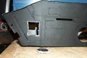

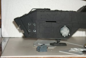

Forward Bolters:
Since my Thunderhawk is outsized I have elected to use Landraider sponsons.
Cutting and placing these sponsons had best be left for the end of the detailing as they have to fit right in the proper position. I was lucky in that with virtually no planning on my part the sponson fit as if I HAD PLANNED IT ALL ALONG?

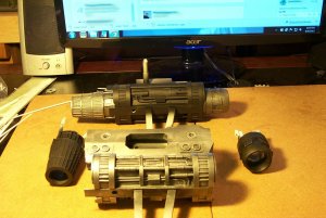

After drilling the corner holes I used an Xacto keyhole saw to cut between the corner holes.
Forward Bolters:
I then pared the excess styrene to the penciled lines and filed the hole carefully for a snug fit of the sponson inner flange....
The plugs fit snugly; better than I expected.
12,563
8,059
Looks like it was always there. ;)

Thanks for the replies,

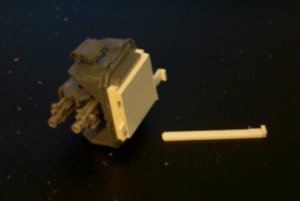

Plug In Weapons:
At the risk of belaboring the obvious I offer my mechanism for quick change weapons. in the image below I have mounted my Bolter assembly with a sliding bolt lock assembly where you slide out the upper and lower bolts to remove the bolter mount. A simple yet effective solution.
Below is the unit removed with one bolt slide in place and the other slide removed.

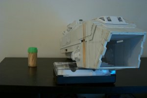

91

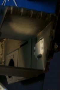

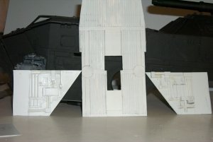

Forward Cargo Interior:
One of the first things (in my optimism) I built for this model was the interior lo these many years ago so yesterday I began adapting the floor and walls to fit the amended exterior.
First I had to cut out the floor to accommodate the nose gear housing which worked out rather well as the front reinforcing stringers gave sufficient height to clear the majority of the housing.
On further inspection of the interior it seems I have room for a few Space Marines on the upper level of the superstructure if the marines can stand and be suspended by a system of beams and hangers; wouldn't that be a rip
