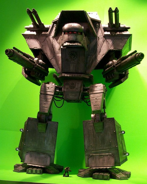

I arrived at Zealot late in my modeling career. Years after I completed Luteus Vexant.
Luteus Vexant Stands 160 feet (49 meters) tall.
This is not a kit. Almost everything is handmade from scratch fabricated from individual bits of styrene.
There are well over 10,000 bits of plastic glued together some no bigger than the head of a pin.
"Luteus Vexant" is the name I chose for the Warlord It in Latin loosely translated means "Dirty Harry."
The Titan has a full interior with five levels completely furnished and manned with a crew.
I am still in the process of wiring the lighting and it needs more paint.

ABSOLUTELY AMAZING!!! The Titan looks like a gothic cathedral turned into a mecha. I would use anthrazite, copper and brown on it. And glowing eyes. :)
