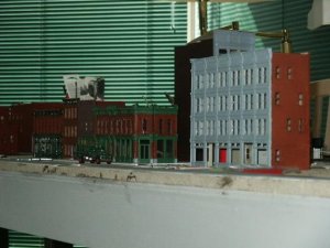

Here's three older photos from last year when I was sizing up building positioning.
I'll post more photos later.

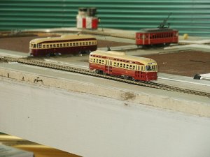

I have several Bowser PCCs which were painted and decaled by Customtraxx. With these PCCs the timeline could be anytime from 1947 to today as several of the prototype Philadelphia cars that the Bowser PCC is based on now run in San Francisco on the F line.
The single trucker is a Model Power TTC class F car of a type retired from passenger service in 1925.

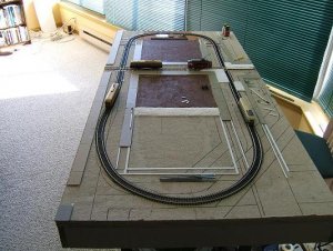

Some details on the layout itself. It's 1/2 inch plywood under 1/2 inch Homasote.
Sidewalks are Smalltown USA and painted Polly Scale Aged Concrete. Incidentally these Smalltown USA sidewalks can make good station platforms. They are scored on the back and can easily be cut in half lenghtwise for a narrower walk. Evergreen Strip styrene #149 strips are glued to the Homasote along the what will be the curb line and #167 strips at the rear of the sidewalk. Then the Smalltown USA sidewalk pieces were glued on top of the strips.
Most of my track is Atlas flextrack. I have used Orr crossings and Orr girder rail on the cross street. Even with the Orr bending tool I found curving rail by hand less than productive so i decided just to use flextrack so I can get some cars running by summer (hopefully).
The cross street is based on 4th Ave in Pittsburgh. It was really a two lane street with a streetcar track down the middle, although officially I think it was an 8 foot parking lane, 10 foot traffic lane and another 8 foot parking lane. Building wall to building wall is less than the length of a 46' PCC car, which makes for an interesting sight line.
The white patches are where I have started to pave the streets with Sculptamold. I'm working in small areas at a time. I will paint the streets a mix of Polly Scale Steam Power Black and Grimy Black to no particular formula (see Paving the Town by Robert Smaus, February 2004 RMC).

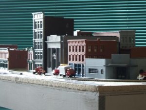

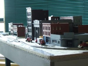

I've attached two photos. One from each end of the layout. At one end of the layout there is an on-street loop and at the other end of the layout is an off street loop.
I have another 30" x 60" table in storage that can be attached to this table to make a 30" by 10 foot layout. But I think the maximum comfortable layout would be 30" x 90". (2.5 feet x 7.5 feet). That's pretty big for a living room. If I go that far the off street loop would become a cutback loop and the line would be extended to a carbarn and L station complex (think Frankford and Bridge in Philadelphia) to give the line a transportation purpose.
For now I'm just having fun with this little setup. Although the layout is on casters I don't really plan on taking it to shows. The compact size is in case I should ever move.

Yes those are Bowser's. They were detailed by George Huckaby of Customtraxx who also painted the PCCs and decaled them.
The Brill is a Model Power from the 70s that I picked up at a train show. It is a 2 rail car, but there are instructions to convert it to overhead operation.
Nope it wasn't Tom Sheppard. He's too busy with his O gauge layout and driving a bus part time.
