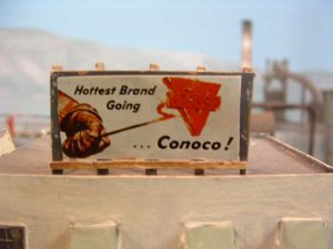

I bought an Athearn Coca-Cola billboard myself, affixed a thin magnet to it, and then printed a number of different billboards on magnet sheets, so I can change them at will. Turned out pretty kewl I think. Hang on I'll see if I can't find a pic.
This one is a Blues Brothers movie poster, which came out at the exact time of my layout. Definitely helps set the era.

Originally posted by rockislandmike
[I bought an Athearn Coca-Cola billboard myself, affixed a thin magnet to it, and then printed a number of different billboards on magnet sheets, so I can change them at will.
More questions. How do you print on magnetic sheets? Where do you find them? I like the idea of being able to change the sign, since I think a couple of these may end up on one of my N-Trak modules. It should keep them coming back for more!

Most bigbox office/stationery stores should have them. I can't remember the brand name, but they're usually with the CD labels and other weird stuff that you can print on. Each package contains 15 or so "sheets" - one side you can print on (bright white), and the other side is magnetic. Simply print on the one side, cut them out, and they'll work just like a magnet.
If I think about it, I'll check the brand name. Otherwise, your best bet might be to go to one of the above stores (Staples, Office Depot, etc.) and ask them about it. They should be able to point it out toot-sweet.
