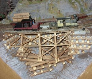

this is what Class A Climaxs look like The MDC hulk is much closer to an On30 Class A in size.
some proper examples on Iron mountain The down hill one has yet to go through my paint shops

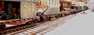

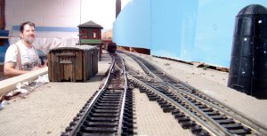

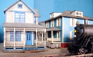

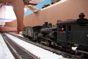

More pictures including TRNL.....Bill
Hey Guys,
Here are a few more pictures of the Clarksville RR club. Included is a good mug shot of that Tennessee Red Neck Logger Bill Nelson himself as he works a coal train. Still do not see any diesels in the pictures including Bill's t-shirt with its mug shot of a shay.
Peace Dr Tom:cool:

Those are both Westside models imports dating from the early 70. The horizontal boiler A , I purchased new many years ago. It has seen very heavy use in the past, and so the heavy weathering put on it 30 years ago seems natural now. The vertical boiler model I picked up a few years back, and It hasn't seen much work. It's previous owner painted it in a scheme that is accurate for a Class A straight from the factory. I need to re paint it to look as much like the other one as possible.
They have a 44 to one gear ratio, and the imperfectly centered axles on the tiny wheels makes them dig in, and pull very well.
on a grade the horizontal boiler unit can sometimes outpull a Bachman 3 truck shay three times it's size.

These two units have been bouncing around the RR in between permanent assignments. #3 used to be assigned as the switch engine @ Terrapin, it was replaced by #15, when it was bumped out of the mill switcher slot for being too slow (gear head reduction motor in a PFM 25 ton Shay) #15 was bumped out of that slot by my Bachaman climax, which has some kind of malfunction going on it it's front truck, and is out of service. I'm thinking of returning #3 to the Terrapin duty, and using the other to move log cars between Terrapin and the Strong and Perry mill @ the Gizzard.
The vertical boiler unit has it's original motor, and with the 44-1 gear ratio, the motor will melt it's plastic brush and bushing block if used for long runs. #3 had two or three original style motors replaced before I remotored it with a heftier motor. I had to butcher the boiler to get it to fit, but after all these years the boiler just looks like it has rolled over a coulple times. I'd have too find a tiny motor if I did the vertical boiler unit, as it's motor is in the water tank. which looks way big to my eye allready, so no long runs for it,
