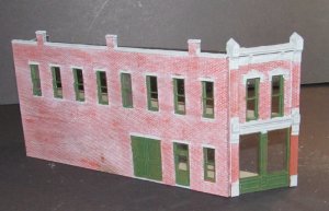

union station and business flats
I have the base together for union station, and have started on the business flats for the nearby street.
The business flat is a Lund Studios product. it looks like some lind of high quality resin, very crisp detail. slightly flexible. I had some trouble getting glues to adhere to it. I eventually used J B Quick with some thin wood backing. this will be on a street along the back drop just to the right of Jackson street and the union station

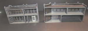

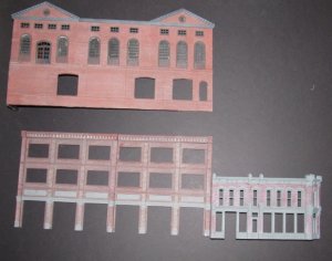

made some progress on some flats, the Lundt studio flats, a DPM structure I cut in half to make two flats, and an old flat that was a a brewery on the backside of Harlow before I did a redesign back there. it was at the club, came apart, and I have started to rebuild it. I have the short walls and the windows and doors in the 3 storty lundt studios building, I'll get a photo soon.
Note the black foam core foolr on the DPM building that has been cut into two flats. this helps stiffin the building. I have another that will amke the roof, but I'll use it as a template to cut some styrene v grove material into flooring material, so I can do some rudimentary interior detailing these flats are deep enough i will probably try to add some LED lighting, which will help them stand out.

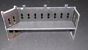

DPM Flats
I have got the glazing, floors and roofs on the DPM flats. all that remains is to splice in the LED lighting. note how much solidity . Floors and walls add a lot of solidity to flats, or any buildings.

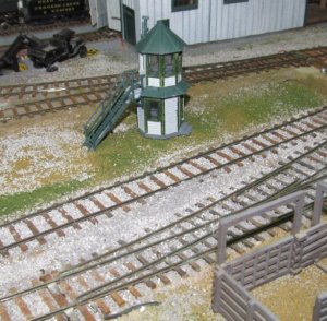

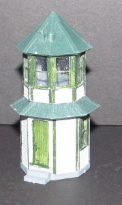

a mini tower
I have been looking for some small elevated tower to control the crossing @ Patterson, where the lead to the Patterson#1 coal mine crosses the main. I had originally planned on using an Atlas elevated crossing tower, but those got back ordered. I eventually bought this Walther's kit for an elevated crossing shanty. they come two in a kit, and I have done most of the painting before assembly. this first one will go to the club to guard the mine crossing, and the other will probably go to my home road for use in Harlow , Tn . guarding the junction of my DG CC &W RR and the Southern Main .
I haven't put the stairs on it yet. the snow on the structure is a result of sanding the pre painted edges where pieces join together so the paint won't interfere with the glue joint.
The green trim looks a lot more solid to the eye, the flash kind of overpowered the tiny structure.

Patterson tower
I got the patterson tower but the rest of the way together. rather than photographing it on foam core I dropped it on my home layout in Crooked Creek. It fits right in as the J. E. Patterson Coal and Lumber company and the DG CC & W RR have identical color schemes for company buildings ( I hear there are interlocking directors). in any case the Patterson tower now has its staircase, and just needs some touch up to the paint. I have left the roof loose, and have a hole drilled through the lower floors so I can light the structure easily later, which should be dramatic.
