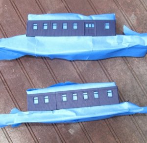

I picked up some spray paint cans on my way from work and the M & N G passenger cars are not purple any more. they are slightly too glossy, I'll need to try hitting them up with a clear satin finish
Nelson

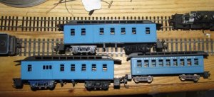

still not right, but st least not purple
These M & N G passenger cars are nor right yet, but at least they are not purple.
I photographed them in front of the State Line Union Terminal, in state Line Georgia, on the fourth level of my current railroad, behind some M & M G narrow gauge equipment that is closer to the desired color. I will have to get over to hobby lobby and hunt for a bottle of something closer in acrylics , but at least they are not purple any more.

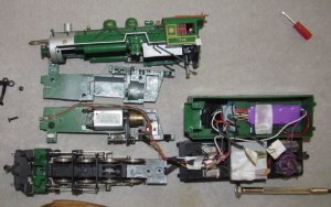

in the next couple days I am going to crack open the Southern #722, and totally re wire the motor circuit, and see if I can get it rolling with the tsunami.

on another front I have torn down Sou 722. removing the wire to the motor I found a solder joint that separated when I pulled on it, and that might be the problem, How it worked 3 times when DC was applied through it, and pasted two continuity tests I will never know, unless the power provided by a dcc decoder is more finicky. One never knows when an intermittent will mess up your diagnosis attempts. In any case I think we may be on our way to operation. with old # 722
We may still have some programing issues, I wasn't able to get the light working after Tyler reset the tsumai to factory settings, but the digitrax systems have strange programing isues with soundtrax decoders. The folks on the Hon3 list say NCE systems are much more user friendly than the digitrax, and that a NCE power cab has enough cohones to program a soundtrax decoder. They say digitrax is ok for computer geeks, but the rest of us want to use NCE . I am toying with the idea of getting a NCE power cab for a portable HOn3 layout, and patching it in to portions of my home layout's narrow gauge system, and hooking it up to the club narrow gauge system from time to time.

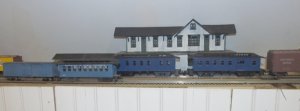

I'm still struggling to get the right color for M & N G Blue I did some paint mixing and got closer. the narrow gauge coach is about the right shade, it is slightly weathered and that is right too.
I got the electrical pick ups on the tender trucks adjusted, and am very close to the sweet spot between electrical pick up and low drag, so it is operable. I fitted the tender shell, now it needs a pilot beam and front coupler. the locomotive runs pretty well with it's new motor, I just have to work out a very minor bind, and it will run flawlessly.

I had mixed paint by taking the light blue, adding some of the manganese blue that gave me the horrible purple, and then adding in some gray to tone it down, it was close when freshly applied and dried even closer, the color changing as it dried has been a continuing story in this project, and worked in my favor for once.

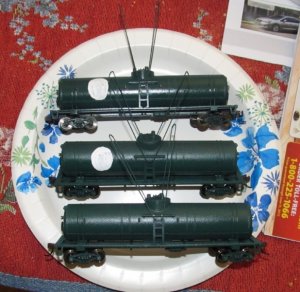

another car project

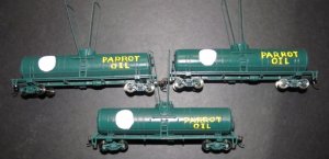

I picked up three Train line Sinclair tank cars from the Walther's flier .
They would not disassemble easily so I toot the axles and couplers off, unhooked the hand rails and moved them out of position, so the tank can be painted with the hand rails out of the way. This will leave a little shadow of silver on the little platform by the turret , but that will probably get painted yellow later.
The body was silver, and the lettering was black. I thought I might have some coverage issue with the hunter green spray paint, so after the axles were out I masked the truck journals and spray painted the entire car with two coats of flat black, before giving them their final coat of spray paint , hunter green, which I have an acrilic paint that is a very close match, that can be use to touch up and counter paint around the lettering, as well as painting the parrot on the emblem.

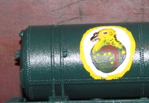

To turn them into Parrot Oil cars, they get a white oval, and the yellow lettering . I started out using very fine paint brushes, but on some of Tyler's projects he has used wooden Tooth picks. I tried the tooth picks and really liked the control, I got lettering with them. the top photo shows my lettering with a brush, and the lower one shows the lettering with a tooth pick. I have gone back and re worked the first round of lettering with a tooth pick counter painting ( touching up with green, to clean up the lettering as much as possible ).
Next I will start on the parrot emblem, which starts with a green oval in the lower 2/3rds of the white oval, then I work in the head, beak and wing details, I'll try to demonstrate the process. I have done so many parrot emblems on tank cars , oil trucks , gas stations , storage tanks, and tow trucks I have the system rather formalized. I will outline the procedure for doing the emblem in the next post.

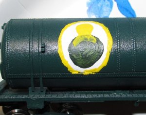

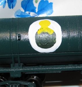

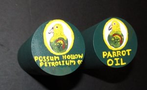

parot oil emblem

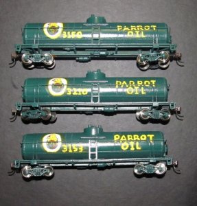

some progress, here is how it is done. I have the emblems done on the tank cars, I just need to do numbers now. this emblem just needs a little counter painting to smooth out the outside of the oval

I have the three parot oil cars done, and ready to go to the club, and started working on some Plastistruct storage tanks for the Possum Hollow Petroleum Co.

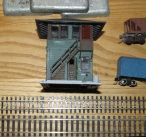

The tower is in place where the east and west leads to the big yard diverge, Tyler recommended that we call it the BF tower, BF standing for Befuddlement , as that section of the track plan is especially confusing when one is trying to operate , as both directions qualify as east or west.
This weeks project for me is reworking the Possum Hollow Utility district's water tower

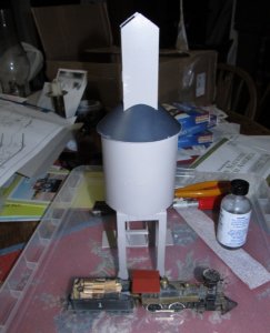

water tower almost ready.
the water tower is almost ready, it's bulb was burnt out. I need to get another bulb or a LED, and it would be cool to find a way to make it flash.

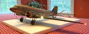

I used flashing red and green LEDs for the wing tips on the model plane I built for the museum. See below.
It is a good company.
Tom

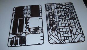

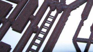

painting parts
I am painting parts for the coaling tower, painting whole sprues to keep the process simple. I am using my technique of painting with a can of flat black and a can of red aouto body primer at the same time to mix the paints on the sprues to give me a rusty iron look.
I have been modifying this kit, which has the dump track elevated considerably. I do not want to go to the trouble of elevating the benchwork for it, and neither do I want to build a very low trestle, so I have sanded the bottom of the pit structure so some homasote roadbed from Homabed , laid n the homasote floor of the big yard, will bring the dump track up to the height needed, and made some modifications to the rest of the structure to get the fit between the two parts right.
weathering this structure is a real mental challenge, as the ones I have seen were derelict. oddly enough these things were probably dirtier when in use, due to the coal dust. I'm trying to do as much weathering as I can before I put all the details on. the next step is to but some rust stains under where the metal pieces fasten on. This is a lot of fun, Thank you Mack for dragging me out to the middle of nowhere Ga. to see these things in person .
