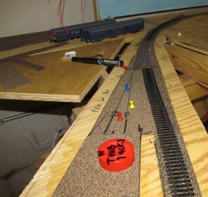

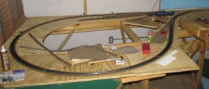

we tested one of the shinohara switches with some long equipment, and dis not have any momentary shorts, so we are hoping the solid points on the shinohara switches will not cause us grief, and Tyler started blocking one in on the front of the helix down to the lower level staging. this will reduce the track to a single track main by the big yard, we have a single track main everywhere else, and the single track main will make setting up the yard much easier.
on the other end of the layout Bob and I were getting some track down on the outside of the return loop at the lower level far wall. So far I'm just putting in the outside track and the switches to the inner two tracks where we will be able to store two trains in off layout staging.
Bob and I had a lot of fun trying to get the #6 switch in on the outside of the loop positioned where it will cause the least disruption to the smoothness of the curve
