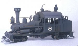

Glad you like the Heisler Tyler. Please give it a good working over. It was one of my original HO lokies and it will be good to see it get a complete "makeover." Bill has got all the replacement parts you might need from a few other Heislers scrapped over the years.
I am thinking about converting one of my "new" Heislers to On30 using a kit that can be used for this makeover. The kit is from Keith Wiseman and here is a picture.
Doc Tom:wave:

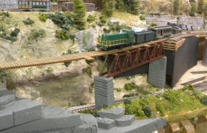

I spiked some rail on the last switch in the mill complex, next week , God willing, I can start soldering it up and hooking up wires L brought the camera here are photos the last switch and the piers I painted for the narrow gauge bridge last week.
bill Nelson

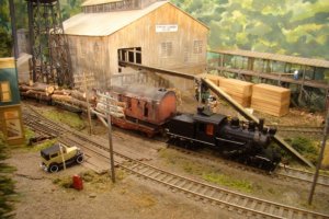

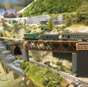

Bill,
Great shot of the narrow guage bridge. Very colorful consist too. It picks up the greens of the scenery quite nicely. Love the carved foam!!! Keep up the good work.
Doc Tom:thumb::thumb::thumb::thumb:

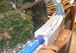

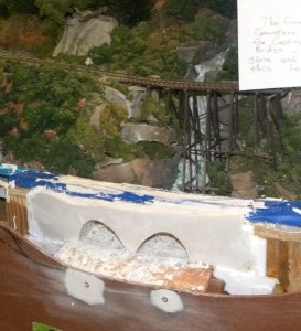

I poured the plaster, and broke down the form on monday. we also ran the DG CC & W track cleaning train some. it worked although one of my riverossi heislers kicked the dcc circuit breaker when it was in the curve closest to the DCC electronics.
The our went well, some leaked under the arches and had to be chiseled out, and the arches deflected some from the wieght of the plaster. so the arches will need to be carved on a little to become symmetrical, once I have it shaped correctly I can start thinking about carving the stones into it.
Bill Nelson

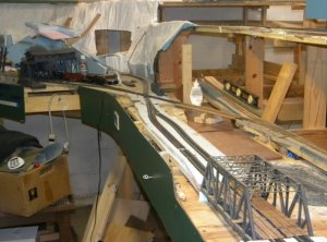

Progress @ the club!
I dragged my carcass to the club last night in spite of some asthma that was making me wheeze and couch up a storm.
I got the Patterson side of the lower lift out section rebuilt with a cut up Atlas re-railer, which will make the track joint perform better, and be much more robust and dammage resistant during removal and storage. I also soldered up a plug for the wire connection, so we are no longer dependent on rail joiners to provide power to the lower lift out.
After that was in I ran track cleaning trans up and down the main and the passing siding @ Patterson, and all the way over to the deep end of the next aisle. I got the tracks on the lift out clean and next week I can bring some tools for manual cleaning rail, and start to push clean track down the mainline over in Eric's sphere of influence. Some scenery work has been done there , and even the marvelous DG CC & W RR track cleaning train does no good when the heislers wont run.
I ran my AHM 4-4-0 and 2-4-0, which was disappointing they run much better on DC, and they cut out near the DCC main station, just like the heislers from the track cleaning train.
I did run #21 the oldest of my little River 2-4-4-2's, and it ran well, although the DCC doesn't feed full power to the DC locomotives so they will not be able to reach full speed or power.
I was planning on dropping some feeders of the tracks in sht sawmill compound, but I had not brought my butane soldering torch, so I put that off till next time.
Bill Nelson

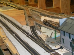

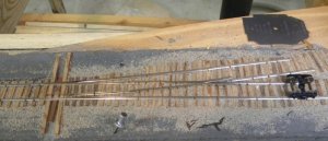

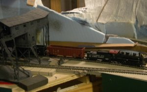

In the weeks since I have posted, I hooked up the sawmill area to DC and ran some trains. I did have a short when one switch was thrown in one direction, but I quickly found where a had the wrong wires connected to each other; and the saw mill area ran well on DC.
Once I knew it was working on DC, I disconnected the DC, and hooked it up to the main buss for the DCC. after that is is working as expected, so the sawmill area in on lone.
Since then I have been cutting material to fill in the holes between the cookie cutter road bed in preparation for some basic scenery in front of the rear track. Behind the rear track, we are not doing anything yet, cause if we rebuild the upper deck as planned to provide a better approach to the Montegle/ Altimont area, We will be able to make the sawmill scene deeper.
The first picture shows the main line , the company store, and the track into the sawmill complex. the track with the log cars on it leads to the company store and some warehouses. the track parallel to it at the back of the scene leads to the lumber loading area.
the second photo shows the bridge where the mainline crosses the log pond. Note the other bridge over the log pond, temporally propped up with scrap lumber. that bridge leads to a crossing across the main line and then to Patterson #1, the smallest of the H. E. Patterson Goal and Lumber company's 3 mines. the track over by the level will lead to a hidden storrage area where empty log cars can be stored, or full log trains can be moved to get them out of the way of trains switching the mine.
The third photo shows Patterson #1, an AHM old time coal mine, and J. E. Patterson Coal & Lumber Co. # 43 a Proto 2000 USRA 0-6-0 with DCC and sound. It ate my train budget for an entire year, but is was well worth it, as it looks and sounds great, and is the best behaved locomotive on the club layout.
I still have some rough spots to iron out on the handlaid switches,
I was taught to build the switch without guard rails, and to run it for a while without guard rails, tweaking it to be as reliable as possible, before adding guard rails, as guard rails can mask some problems with switch geometry. In any case the handlaid track is close to done here, so I am thinking about what to do next. Perhaps a passenger station near the big yard.
Bill Nelson
