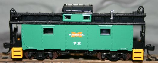

This caboose, an Atlas NE-6 for the Monogahela, arrived at the Wilmington and New York Railroad on Saturday via U.S. Postal Service (well, you know what I mean)
A bit more than 24 hours later, it emerged as the latest addition to the roster.
I did cheat a little bit and assign this to the 1980's roster of the Wilmington, which consists of stuff that I like that would not fit in 1963. (The NE-6 certainly existed then but the Wilmington couldn't afford one then and was largely making do with wood cabeese, Micro-Trains and MDC models.)
The herald-- which should look awfully familiar to New York, Ontario and Western fans-- is the W&NY's, but the caboose has been assigned to the Whiteface Mountain Terminal Railway, which was only a "paper subsidiary" by 1976.
There are other things that have been in the paint shop for many months, but this one was "expedited"... more to come.
Technical details: Stock Atlas caboose, Micro-Scale decals (O&W Diesels and Cabooses). Monongahela herald removed with Easy Lift Off-- no sweat at all, the lettering comes right off with a few seconds and a little rubbing with a cotton swab (Q-Tip). Extra yellow details done with Accu-Paint. Trucks and couplers kept as is, at least for now.
