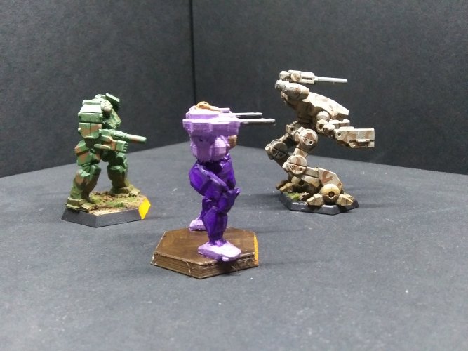

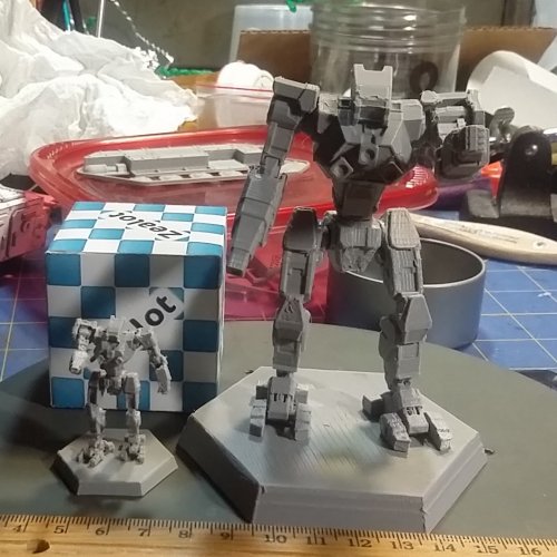

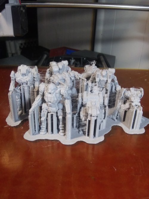

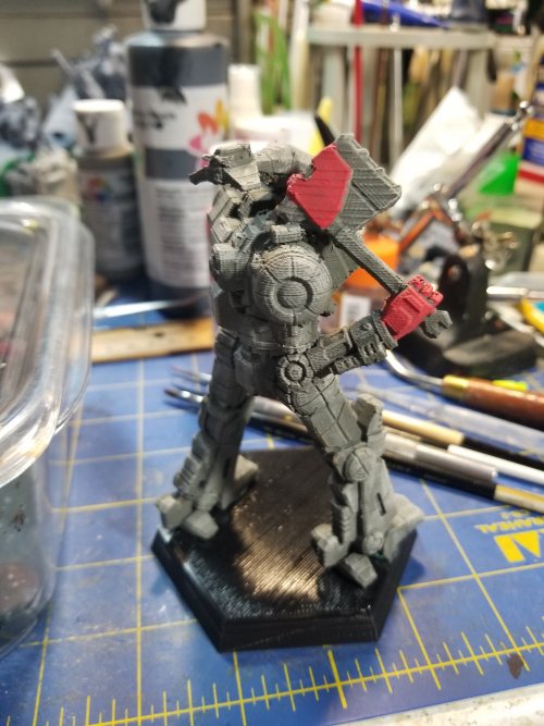

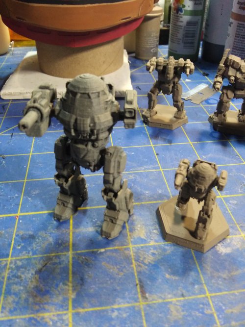

Here are a couple of Urbanmechs I printed. Left we have one that is viable for 15mm (1:100th) scale table top games, or decoration, and on the right, the 6mm (1/285th) scale used for Battletech on the map sheets or miniatures rules.
Just to the rear, you also see a primed Blackjack and Awesome in the 6mm scale. These all had a layer height of .14mm and a 20% infill. I found the need to use a raft as the feet on the 6mm scale are too small to effectively sit on my PEI print bed. They required support, and I used zig-zag at 30% at first but had to re-assemble the small ones a lot as that was too dense and pieces like feet and gun barrels fell off while I removed supports!

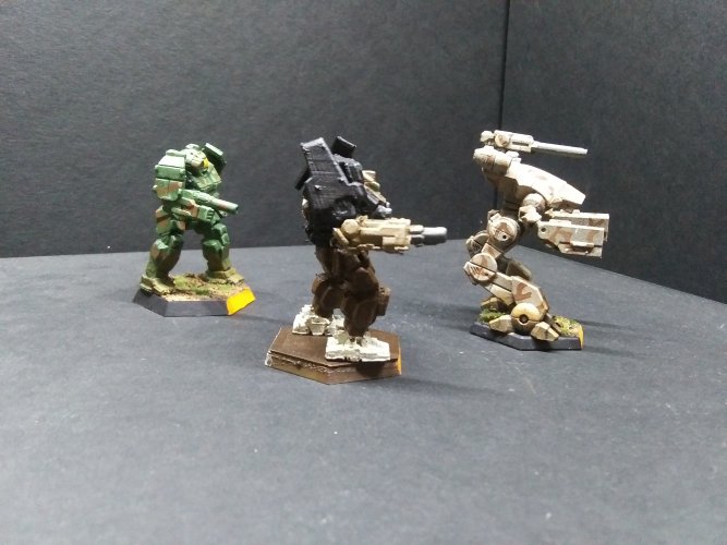

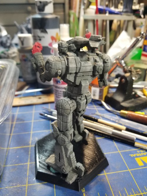

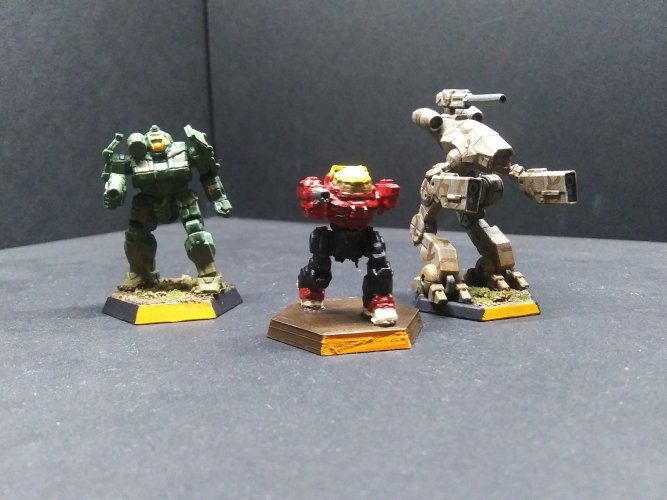

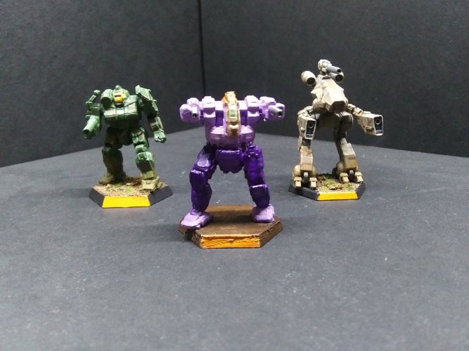

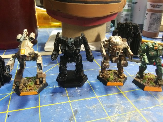

Here is the Awesome next to the resin Stratos Minis (Bullshark on the left, 3D print Awesome, Flashman, and CGL Griffen). I learned NOT to print in black for these in the future. The visual pain of trying to clean up black 3D printed plastic was enough... I will print the bases black however, as they have little detail I need to worry about, just some basic sanding.

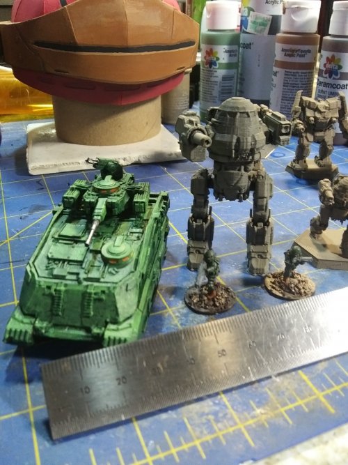

Finally, I had to put this Urbie next to some of my 15mm army and see how it compares, and yes, it works perfectly. I'll try to dig up which model I printed on Thingiverse and post it later. I'm very pleased with the level of detail from the larger scale, as a final product. 6mm scale, well, the detail is good enough to serve as proxies until I get some better models (as in the plastic or pewter and resin kinds). In the mean time, I have some fun models to paint in odd ways, as well as some great beginner miniatures for my boys to paint.

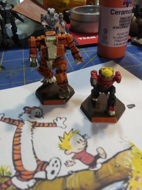

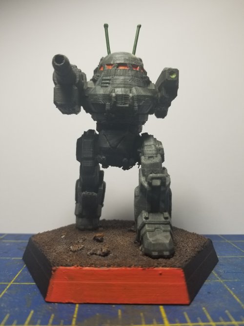

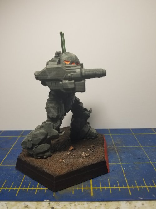

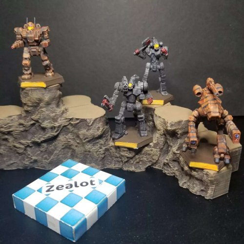

So, for my first paint ups of my 3D proxies... I decided to do something I'm unlikely to do with actual models.
Create a Sunday comic strip inspired lance... Watterson's World Defense Forces militia... Lead by Calvin and Hobbes.

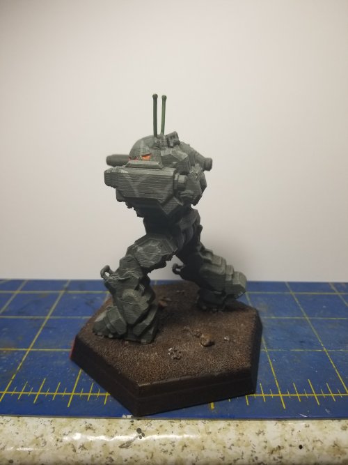

Printing stats: 3D Print Life gray Pro PLA
Extruder Temp: 200 initial layer/195 print temp
Bed Temp: 80 initial layer/ 50 print temp
Layer Height: 0.1mm
Infill: 20%
Supports: From bed, lines, @15%

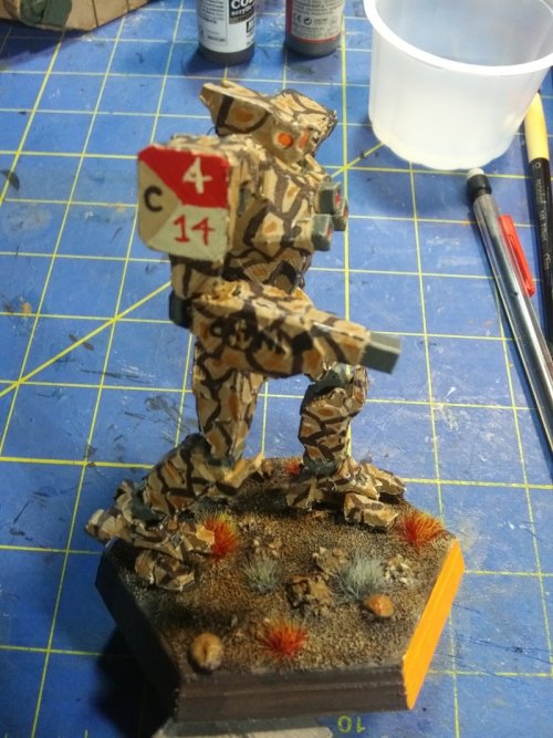

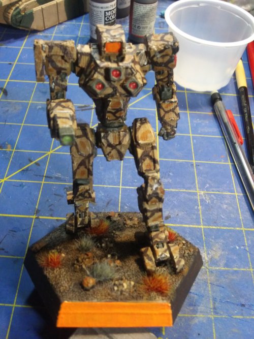

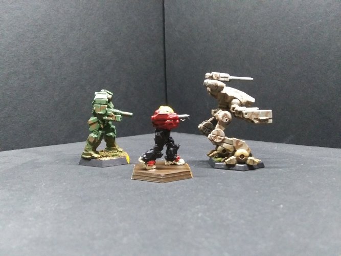

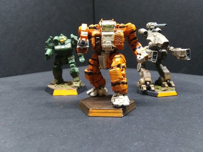

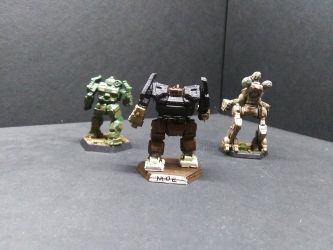

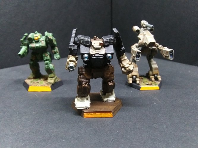

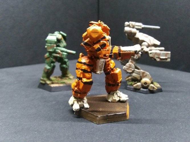

Here we go, a quick break down of each mech. 3D printed mech is between a CGL injected molded Griffin and a Stratos Minis resin "Bullshark" (counts as Maurader)

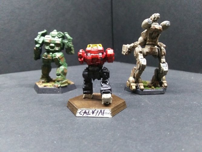

Calvin, Urbanmech:

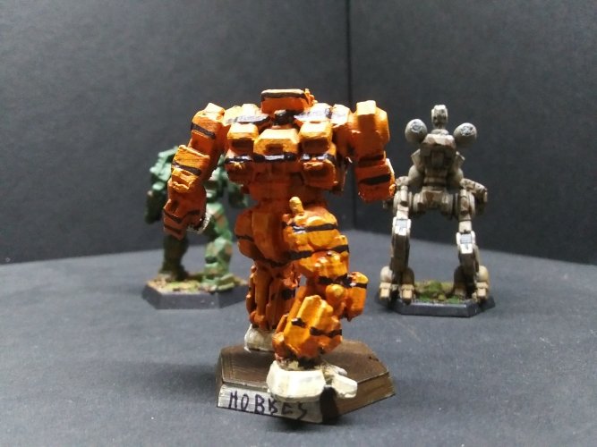

Hobbes, Highlander:
Suzie, Blackjack:

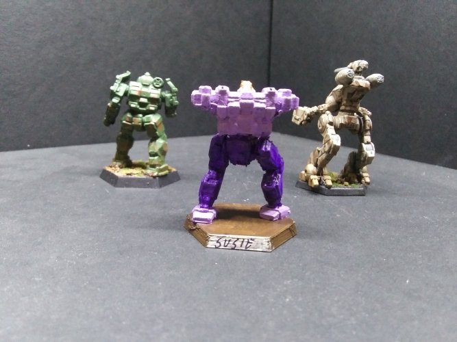

Moe, Awesome:
