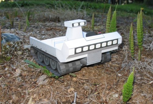

As we all know, @Revell-Fan created a great template for the Battlestar Galactica Power Sled (Chariot) back in 2012. I conducted the original beta test build of the Power Sled in that same year.
Here is a photo of the original.

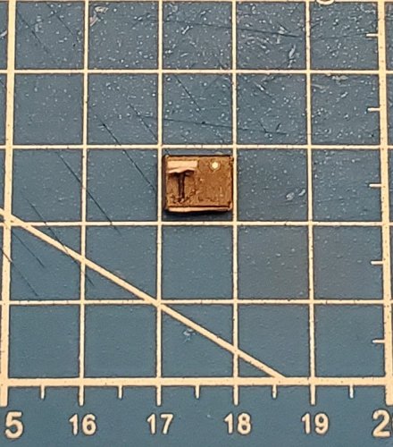

Here is the main box for the drive controls.
The main box for the drive controls is in place.

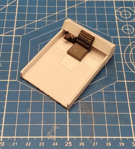

Do to design spec and scale issues as well as a few changes that had to be made, I am starting over with the PS project. With that being said, Once I start building, I will catch up to the last photos posted and continue posting updated build pics as I go along.
11,000
7,520
As mentioned earlier, I had to start over with the beta build, after a few changes were made. During the time that the changes were being made, there was quite a bit of research that was being done to make certain that everything was being made as screen accurate as possible. However, with that being said, there were a few minor changes that were made due to creative licensing (due to either not being able to distinguish what something was, how it was constructed, or just the simple fact that we threw caution to the wind. Either way, you can decide which is which).
So, (after conferring with @Revell-Fan) I have decided to (essentially) start from the beginning and chronical everything that has been done in this thread. With that being said, shall we jump into this once again.

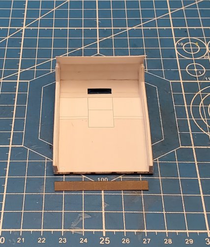

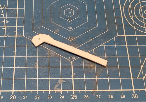

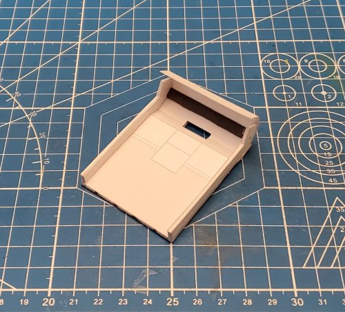

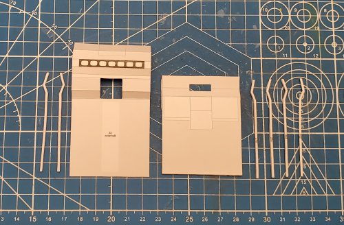

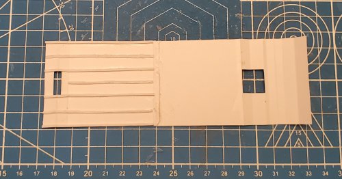

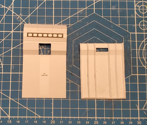

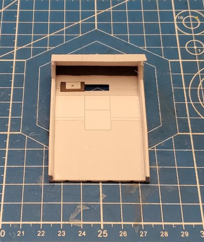

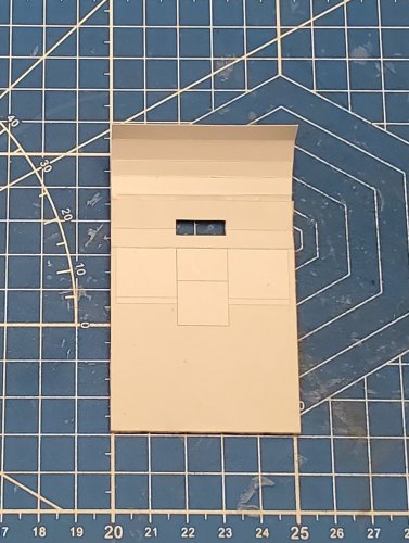

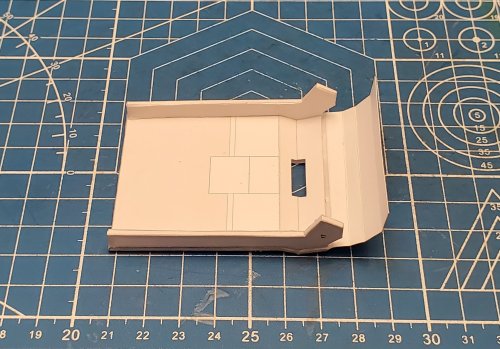

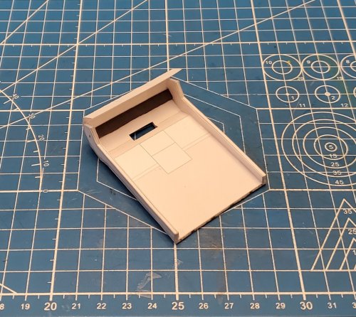

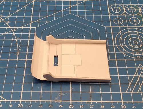

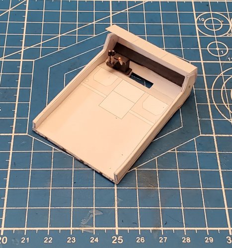

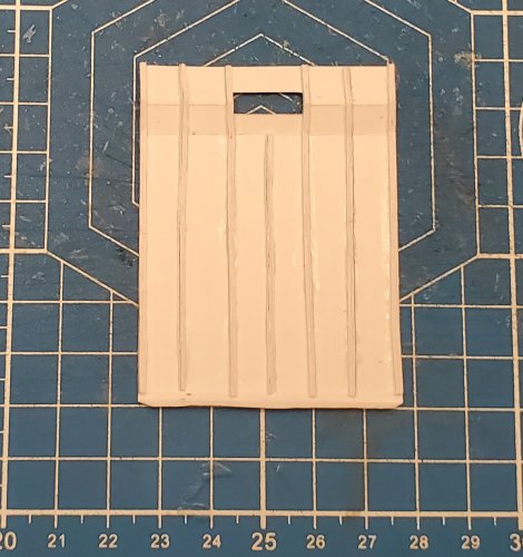

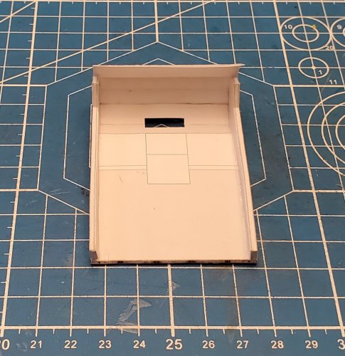

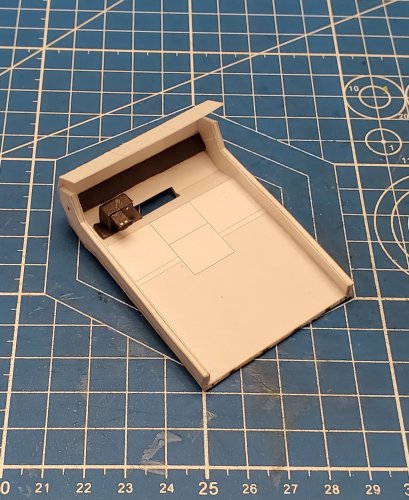

Starting with the main body of the Power Sled, I printed the template twice (for the extra parts). I laminated the formers and the side pieces to (roughly) 1mm. I attached them to the inside of the top body plate.
I connected the top and bottom pieces.
Now forming the main body.

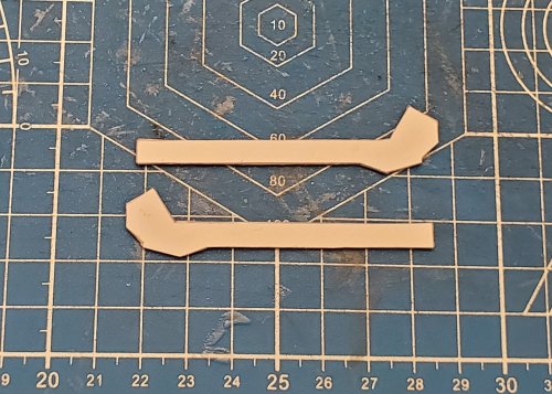

Here are the parts for the main side panels.
Both main side panels are assembled.
The main side panels are attached.
The kickplate is in place.

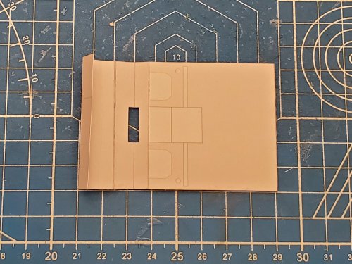

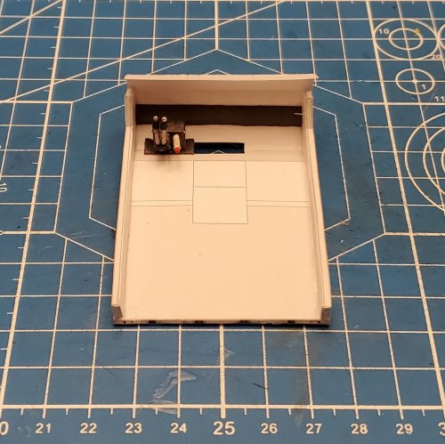

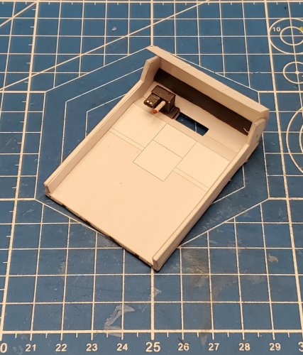

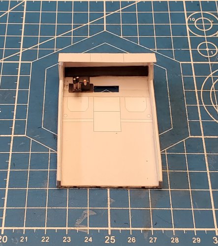

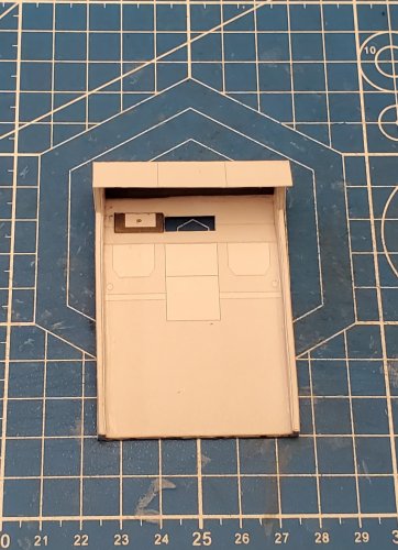

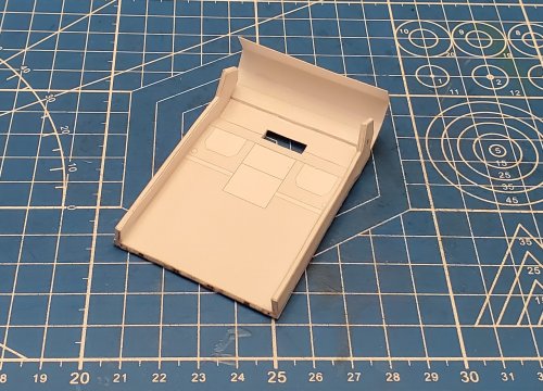

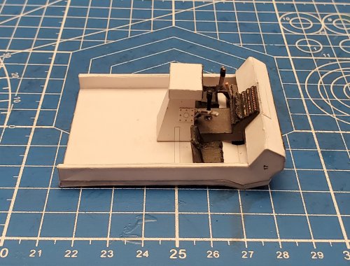

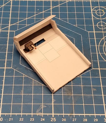

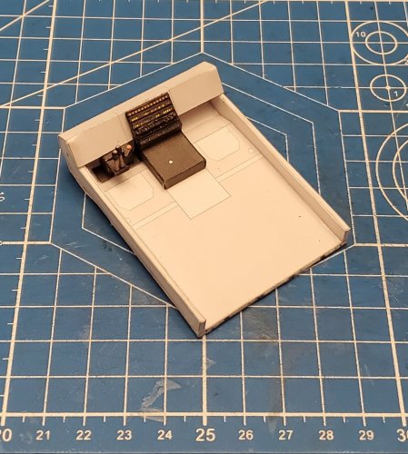

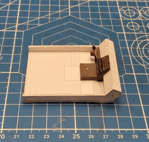

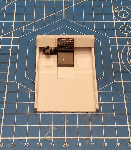

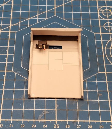

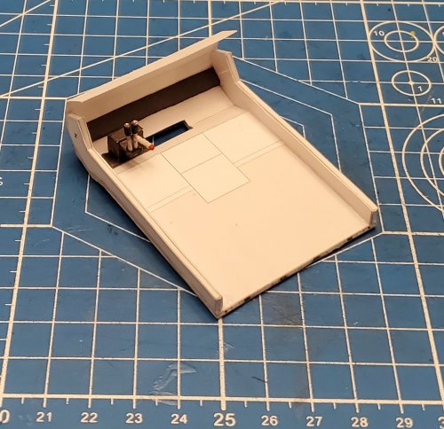

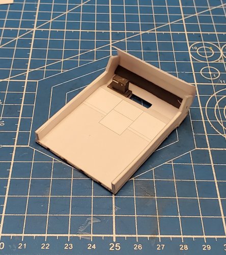

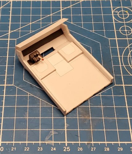

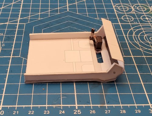

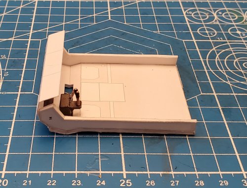

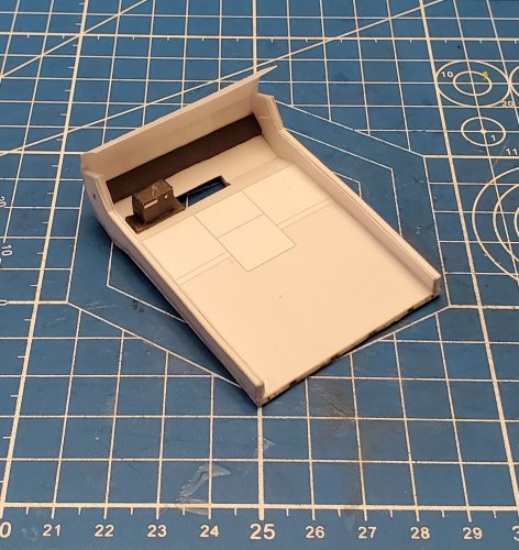

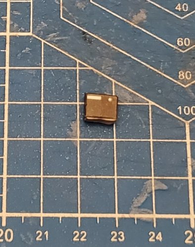

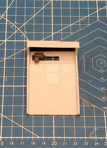

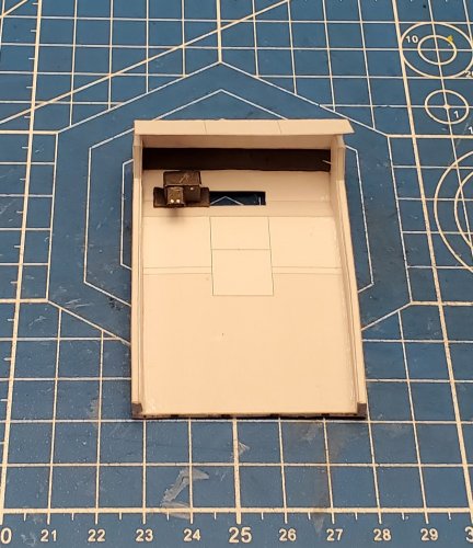

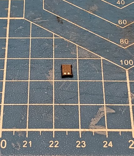

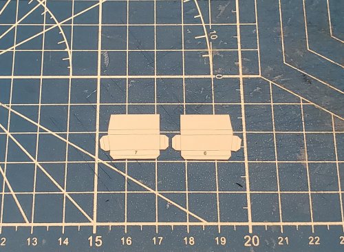

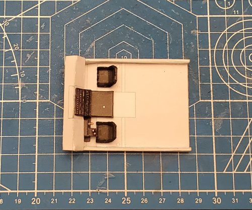

Now to focus on the drive control system.
Here the the base plate for the drive control console.
The base plate for the drive control console is in place.

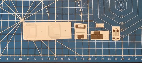

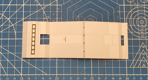

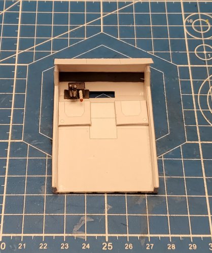

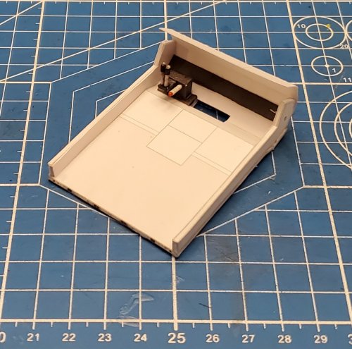

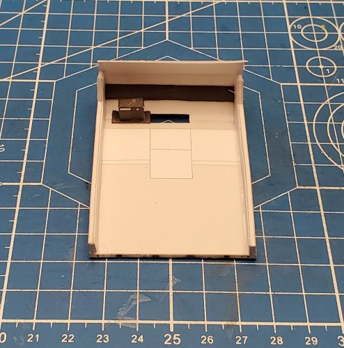

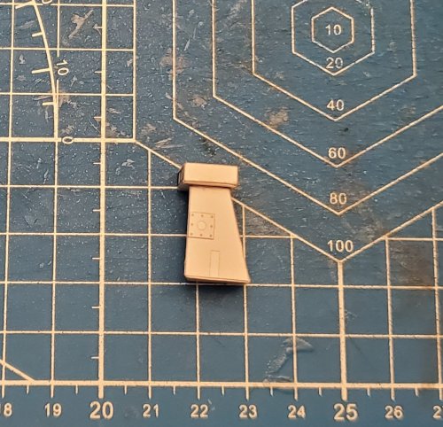

Here are the parts parts for the main box for the drive controls and the mount for the drive control sticks.
I mounted the bracket to support the mount for the control sticks.
The main box for the drive controls and the mount for the drive control sticks are in place.

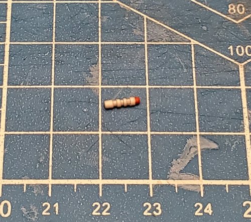

Here are the controls stick.
The controls stick are attached.

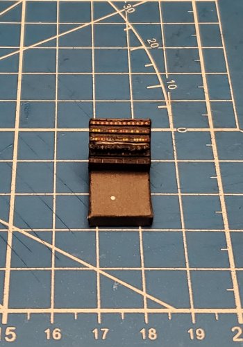

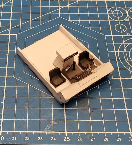

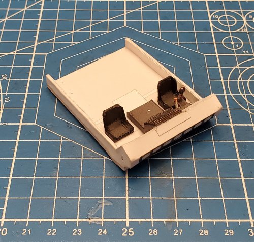

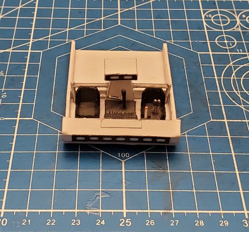

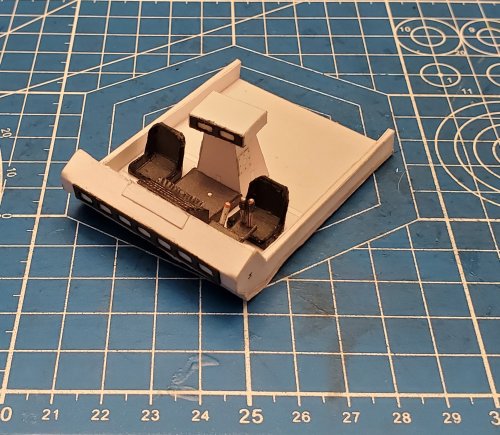

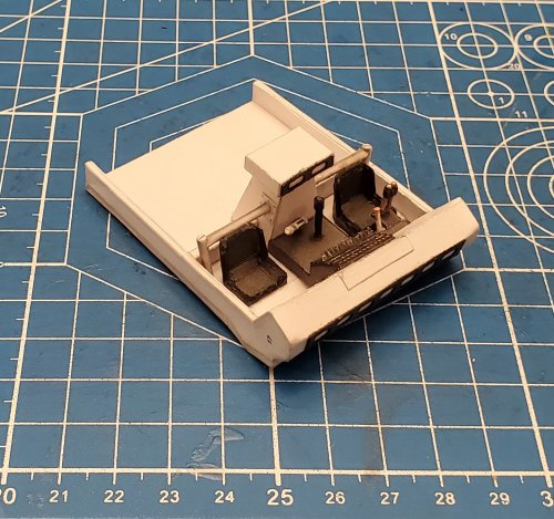

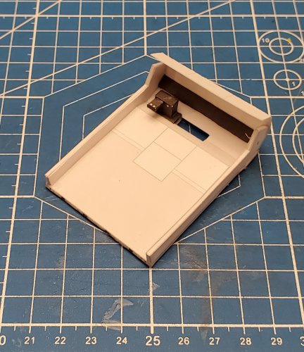

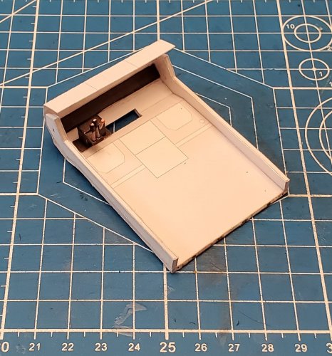

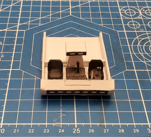

It is time for another long awaited update.
This time, I am focusing on the instrument panel, seats, light tower, extra levers, roll-bars, and the back walls.

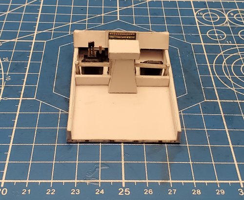

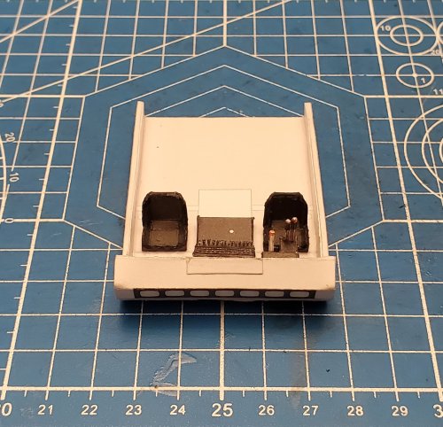

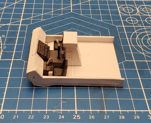

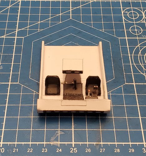

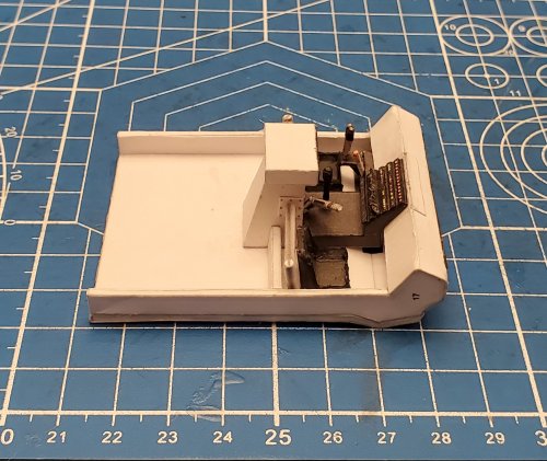

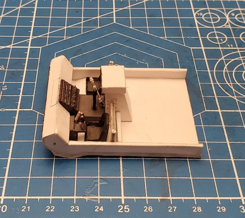

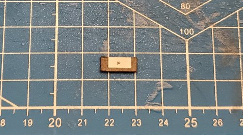

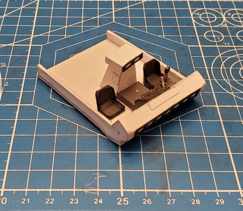

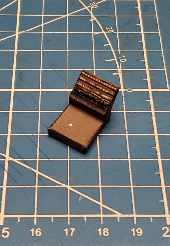

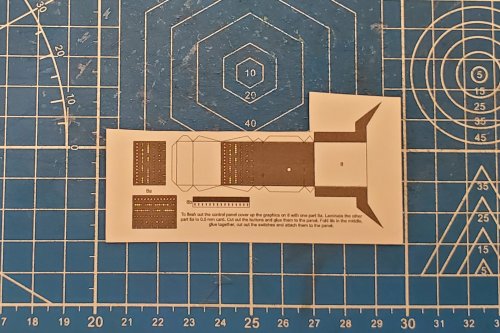

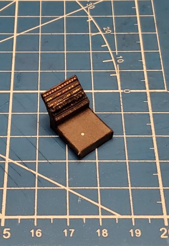

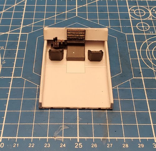

Here are the parts for the instrument panel.
The instrument panel is assembled. I have raised the rows of lights as well as attached all of the individual switches.
The instrument panel is attached. T

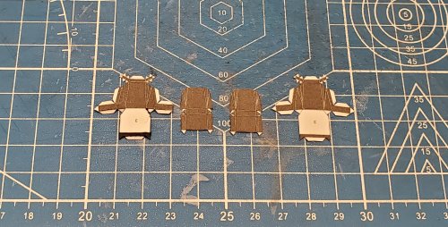

*NOTE* These next few photos also illustrate one of the changes. As you saw in the starting of this thread, there were seat mount plates. They are no longer included, as they raised the seats too high.

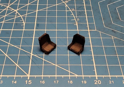

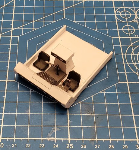

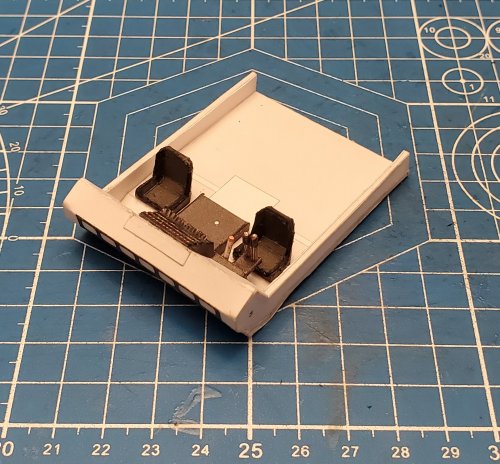

Here are the parts for the seats. Yes, they are a bit fiddly. However, if you take your time, they really are not that difficult to make (even at 1:50 scale).
The seats are assembled.
The seats are put in place.

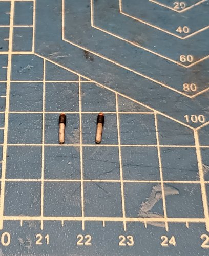

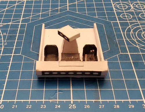

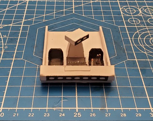

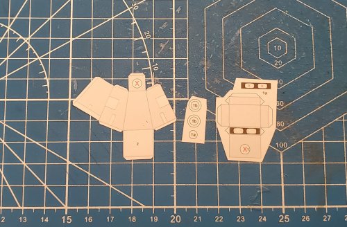

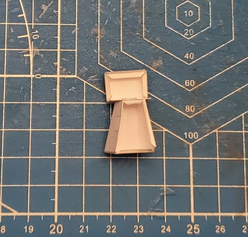

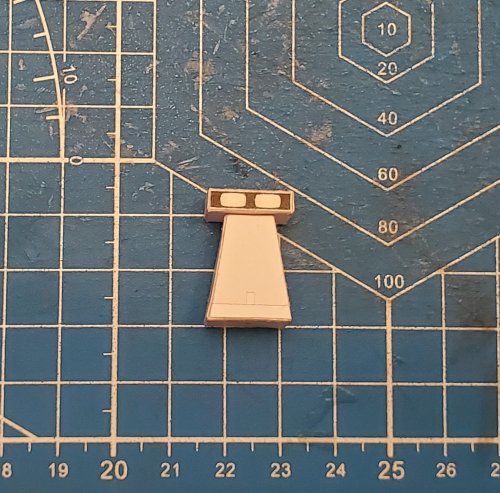

Moving on to the light tower and the extra levers.

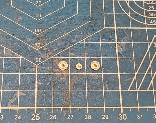

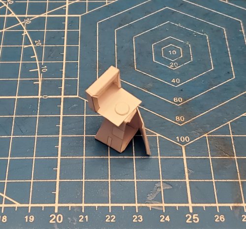

Here are the parts for the light tower (*SPOILER ALERT* Yes, the light bar will rotate).

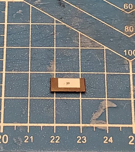

Here is the rotating mount system. I have laminated parts 1b twice (the parts are two layers of cardstock for added strength), and 1a three times (the parts three layers of cardstock. This will insure a tight fit, whilst still having enough room to rotate freely, and not wobble.).
I partially assembled the tower and the bar, so that I can connect the two components with the rotating mount system.
The light tower assembly is complete. I raised the black area around the lights and recessed the lenses.
I attached the roll-bar mounts.
The light tower assembly is in place.
As mentioned earlier, the light bar does rotate.

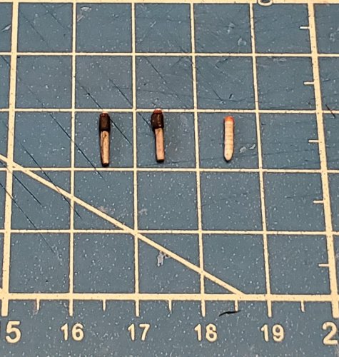

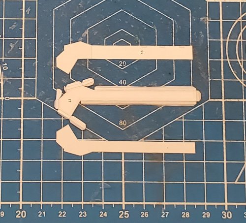

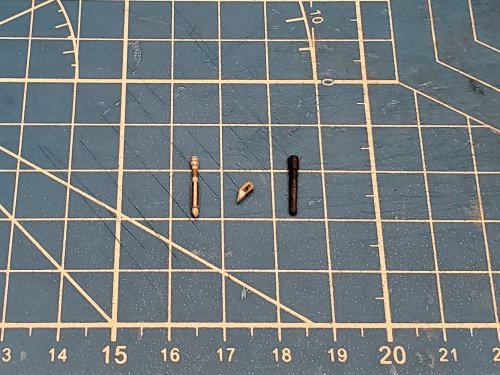

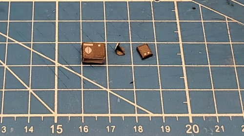

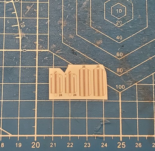

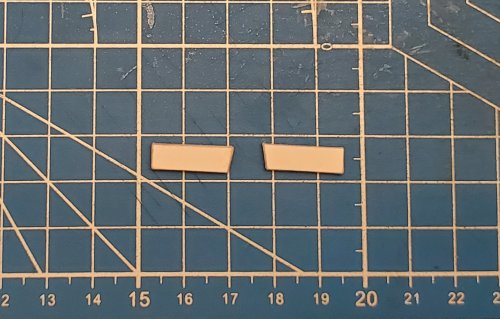

Here are the extra levers.
The levers are in place.

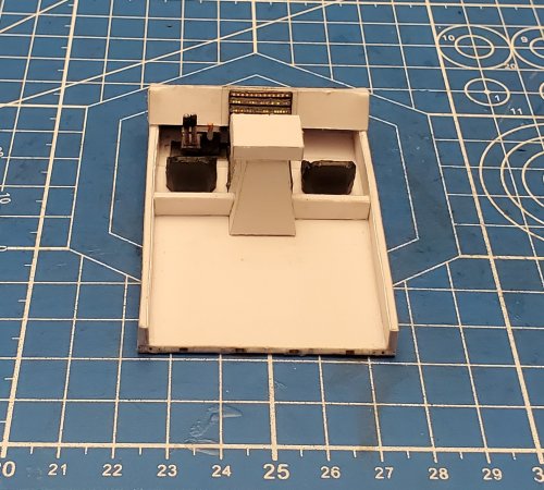

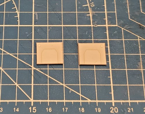

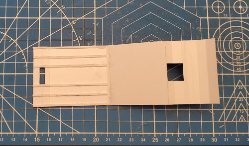

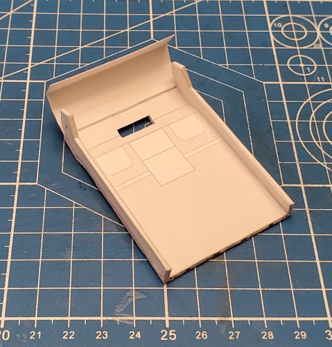

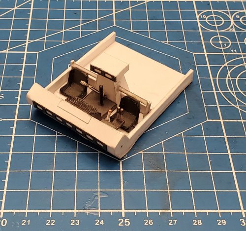

Moving on to the back wall sections and the roll-bars.
Here are the parts for the wall sections.
The wall sections are assembled.
The wall sections are in place.

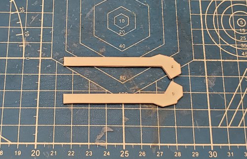

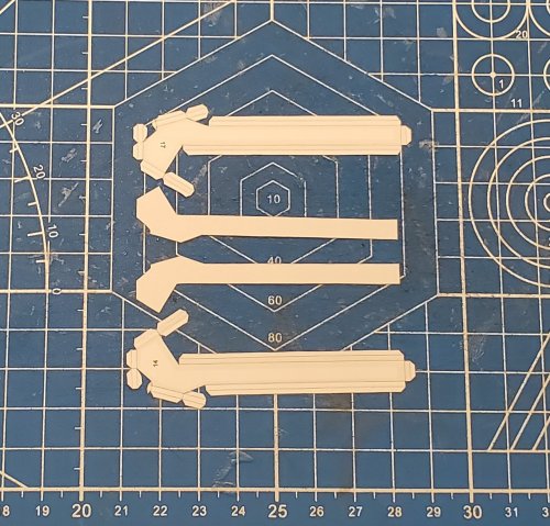

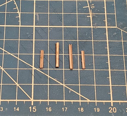

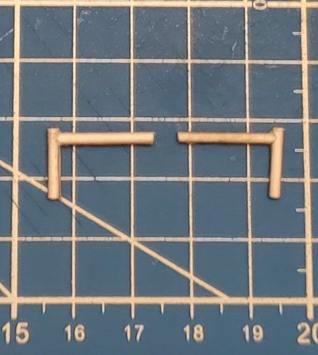

Here are the parts for the roll-bars.
The roll-bars are assembled.
The roll-bars are in place.
