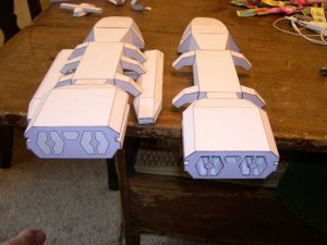

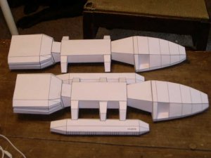

Glad its working well so far! Not surprised that she's buckling here and there, I'll whip out the hammer and chisel, and make some internal bracing and templates for the next version. Lots of glue marks, uncoloured edges..... Hey that's what a beta is all about! slap it together quick and nasty, so she can zoom around the room, and blast the bad guys. ( insert appropriate sound effects) You've done well considering there is no guide or part numbers, give yourself a gold star! you'll be able to write/compile the assembly guide with your eye's shut. :wink:
*Do you think the Engine Buckle issue, could be fixed with some bracing/internal template or do recon it needs a bit of a redesign? ,,,,???... as in make the engine module more of a 'box' shape = without the groove, then add the ridges on to that as separate parts? (The flaps can be made to resemble plating)
*What sections would you brace ~ if you can give me an idea of what you had in mind, I'll try to supply them in card with the model.
*Were there any parts that you found to 'Fiddly" or complex to fold? = would have been easier to assemble from smaller sub sections?
*How big is it going to be? = Printed on 'letter' ? big enough / to big?
Master Plan ~ Once the basic construction issues are ironed out, I'll dev some surface detail = bridge, ( build-able ) Engine ducting etc. ?? plus, rather than a bunch of complicated part number/placing issues, I had in mind to supply a page with some generic shapes, plating, pipes etc. Then texture it with bitmap editor for the polished goods.
Thanks for the assist and feedback Doc.

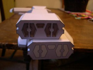

Hey Gearz!
She's done!
* engine buckle at the forward corners of the grooves may be due to my build
technique...not necesarily design flaw.
* I think that the landing bays and the central hull would benefit from some
form of either internal bulkheads, or maybe just need to be stiffened with
balsa wood applied directly to their internal surfaces.
* I was thinking that the "internal" sections that go into the engines looked
fiddly, buy in my rush to build her, I overlooked the fact that I should have
cut out the white parts and inserted them....so...
* I think the size in pert near perfect...I did notice a reasonably significant
change in size when I printed it out in the Pepakura, vs. printing the bitmap
images (bitmap printed out smaller). Taking all the future "fiddly" parts
(the bridge, the engine ducting, etc) into account, I wouldn't really want to
try to build a smaller version (but I would anyhow...LOL...)
I think she's a beautiful brute of a ship, and even love the way she looks now,
without all her "make-up" on.....You're very taleneted, and I can't wait to see
how she developes....please feel free to e-mail anytime if there is anything I
can do to help....thanks a million!

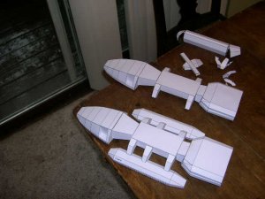

The launch bays can be easily fixed. I'll just slice each into three sections ~ so the 'caps' can be separate parts, that way I can add an end plate to the 'tube' ~ act as a bulk head. ?? Maybe one for the Mid arm point as well? Actually that would make adding a recess in for/aft of each LB doable ~ for a teeny tiny little Viper... Lol
I'll have a think about the internal bracing for the main hull, perhaps a 'slide in' frame, inserted before the 'box' is closed. Guess the Mid arm attachment point, would be a good place for a cross brace as well..mmm.. I"ll nut it out.
No engine recess ~ oooppps... that's what beta is all about. I've done worse than that!
The final release will be bitmaps so I needed to know the sizes ~ Good.... NO smaller!!!!!
'Galactica' name plate ~ YEP you can edit the bitmaps to your hearts content! it will be on the final release version OR you can just add it your bitmap pages ~ add anything you like to any page/part and re print it, JUST DON"T change the page size. You mention the bitmaps were a little smaller but not much I hope.
