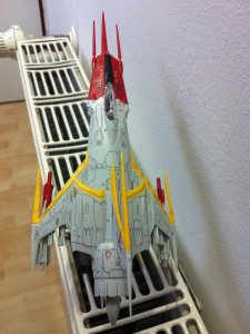

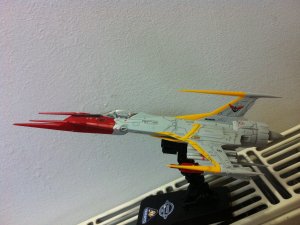

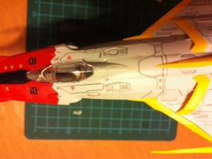

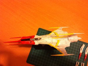

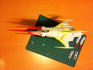

So now next pictures - the decals of the upside of the fighter and some "painting".
I saw it on the instruction that the fighter is not clean but has lines between the plates. I used a pencil to draw this lines - I thing the outcome is ok.

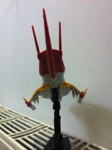

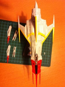

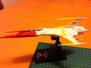

So, finalized:
last Decals and the rockets. I decided not to put rockets on the upper side of the wings - looks to be overloaded.
I play StarLancer at the moment and I like to have some rockets which can be locked to a target and also some which can not be locked to a target.
And this is also the armament which I did with this fighter. The rest remains in the box - who knows, whether it might be useful some time.
