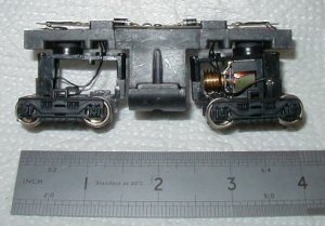

This is pure theory but worth thinking about....... to power (self propel) it the good mechanism from the HO Bachmann Spectrum 44 ton switcher runs good at 6 volts and I feel would be easy to fit. I've attached a pic of this loco's chassis in case you have never seen it's insides.
The plow blades could be driven from a model boat can-motor with an planetary motion in-line gearbox (not sure if these g/boxes are called epicyclic). I think these units are also inexpensive. If the blades motor is fed from a tiny bridge rectifier the blades would turn in the same direction irrespective of the direction of the unit.

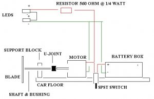

Sketch
Here's just a little sketch of my ideas on the snowplow that I sent to Mike. Thanks to Errol for converting this to the correct format:)

Yes, and thanks very much to Vic for putting together that diagram.
