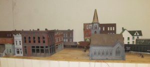

Ahh yes I remember that church, tis a beauty indeed. It's always great to see what you can make out of anything and make it yours. The greatest of modelers need this knack, otherwise scenes are boring when you can pick out what kit is what. That's just my two cents.
I have lots of buildings in mind I'd love to scratch and/or bash. One of them also being a church, the one from my hometown which I used to go to. Since I haven't seen anything close to it made this will probably be a scratch job, but as it always seems when I have something painted or make something, someone comes out with one (like my Fox River Valley SD24 that Atlas came out with a few years ago).

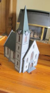

Here is St. Steven's in it's new location in State Line Georgia. St. Steven's had a foundation in old harlow, that was not recoverable, so it will need to have a foundation and front steps built for it in this location.
Bill Nelson

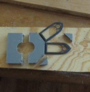

Here comes the kitbashing part. I have to be very careful with the stuco material, don't have much, anything I mess up will have to be done in stone

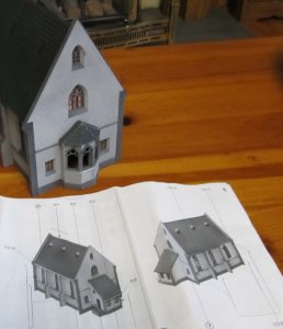

I got the kitbashed bay done for the wall behind the altar , I photographed the church next to the plans , so you can see the anex that I did not choose to build, so you could see what I did not think would fit, and what I thought would fit.
The next thing I need to do is to repaint the roof and details of the bay, and work on getting the lighting installed I'm going to put nine leds in the tower; three above each end wall, and six down each long wall. I scanned the stained glass from the kitchen . I printed the glass, and sealed the stained glass between sheets of packing tape, so the inkjet printing woin't smear when I glue them to the plastic glazing for the bay window.

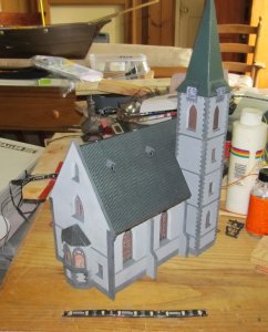

a_harlow_church_almost_ready.jpg I have added some stone trim work to the bay, and the gutters and roof vents to the roof. the only things left are the Led lighting ( a strip in front of the church in the photos,) the tile for the ridge of the roof, and the downspouts. the downspouts look fragile, so I waill wait to put them on till the scenery is done near the church, and it won't have to be moved much, and by that time I will have lost the downspouts, and thus not be able to break them

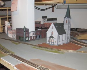

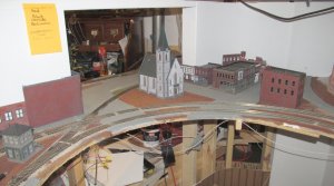

Here is St Cristopher's from the back side of the scenic divider in new Harlow.
and the view from the front side of the scenic divider, which is open here to let the Southern Main loop back on itself to form a return loop.
