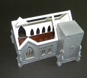

SML Ch flr # 9.jpg I made some progress on the floor, and it and the walls fit well. I have the floor level marked on the walls with pencil now so I can proceed with the wainscoting pretty easily.

Tom that is evergreen V grove styrene. the specifications are lost in time, as it is leftover from , I believe, my last Styrene Skid shack construction binge. I think I have a supply list for that somewhere, as I had always intended to make more. I could use some in Ridgemont, and Gegokayoosa, and it would probably be fun to have some at the club as well; or at least some extras to make a moving day train, without raiding established logging camps.
The thin evergreen v-grove material is lightly glued (to minimize the same warping problem that has me not gluing the interior walls in place at all ) to the same heavy gray plastic material I used for the sub floor. up in the sanctuary area that sub floor is 3 layers thick , which gives me the proper steps up to the sanctuary level..
I made the floor assembly very slightly oversize, After the floor was assembled, I sanded until it would fit tightly in between the interior walls. when I add the glazing it will thicken the walls, and I may need to do a little more sanding. It all fits so tightly that right now, even though only the two walls adjacent to the tower and the tower are glued together: the sub floor, the floor. the other two walls, and all six interior walls are not glued together, they are just a press fit; I can pick this building up by any two opposite walls, and the fit is tight enough to hold the whole structure together.
To get that finish (I used the same technique on St, Joseph's in the Gizzard- my finest styrene scratchbuild, and one of my best builds ever) I took the flooring and spray painted it with flat black to get a dark base, and then I spray painted the rest with a glossy chocolate brown paint, putting on just enough paint to fully cover the board surfaces, but to leave just a hint of the black down in the v-grove. The result is a decent approximation of a dark highly polished floor.

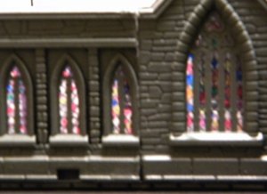

SML stnd gls tst #1.jpg stained glass window test #1
I went grocery shopping at Wally world tonight.
I picked up a pack of colored fine point Sharpie markers, and did a test on some windows. this is the wall that faces opposite the aisle, and is thus the ideal one to practice on.
the effect is ok. although difficult to photograph without a roof and interior lighting. I threw out about eight digital photo's before I got this one. It looks better than this in person.

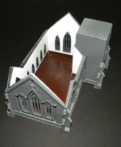

SMLaddg wnstng.jpg SMLaddg wnstng.jpg wainscoting
I'm taking a break from the stain glass. the next window done will be easily visible from the aisle, so it won't be experimental like the first wall.
I'm poking at the wainscoting, which really gives a finished touch to the walls. Once again. I'm just following techniques I developed on St. Joseph's in the Gizzard

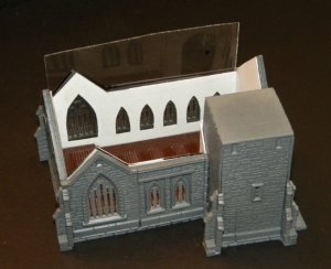

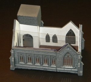

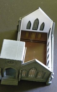

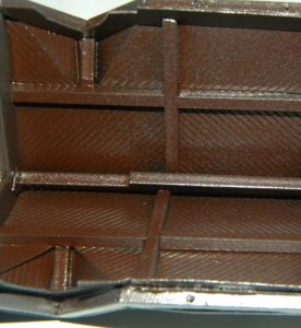

SML ch rf #2.jpg SML ch rf #3.jpg SML ch rf #2.jpg SML ch rf #3.jpg I have the inside structure of the roof assembled, along with a lip, that will fit inside the inside walls, (it is a real tight fit, and a pain in the **** to fit the roof); that should minimize light leaks at the wall roof joint.
I usually photograph more steps in the construction. . I did not do that this time, as this had a lot of trial and error involved. after two or three tries to get something right, I was in a hurry to jump to the next step. Photos of the failed steps would have been a waste of time, photos of the successful steps only would have given the false impression that I knew what I was doing.
Here is the inside roof structure. I need to paint what will be visible from the outside gray to match the stone, and the over lapping flaps for the inside walls will have to be painted white.
There is an unprototypical bump out on the ridgebeam, which will support the LED strip, which is being modified to make it a little more subdued. I'm gluing a thin white styrene sheet over the LEDs to diffuse the light some, and I will try using yellow highlighter on the white styrene to try to minimize the Blueish light from the LED

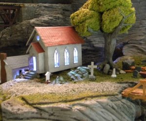

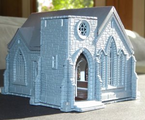

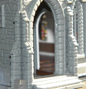

SML ch w rf #4.jpg SML drwy.jpg SMLbtr rf dtl.jpg sml led#3.jpg some progress with the roof , and a photo that shows the roof interior detail (that will never show) better . In the through the door photo , the far wall is not seated all the way down, so there is a white line viable under the wainscoting that wouldn't be there if it were assembled correctly.
The other church in the photo is a scratchbuild of my design, which serves as St Joseph's in the Gizzard. this shows the LED lighting that needs toning down. grain of rice bulbs have a much better color, but they burn out very quickly, and it is a pain to disassemble buildings with this level of interior detailing to deal with the wires, which are attached to the tiny bulbs, and must be hidden.

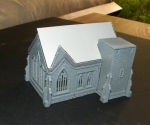

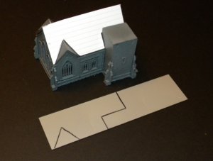

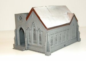

starting on the exterior roof
Being somewhat satisfied with the interior roof, I started on the exterior roof. I had found some sheets of plastic "shingle" material, of sufficient size for the project. This material has long been separated from it's packaging, and so it's origin and specifications are unknown.
Fitting roof material is very tricky, due to the angles which often must be cut or filed into the edges. In the past I have made more errors cutting roof material than anywhere else on a structure. so extra care is being taken here, where I don't have enough material to make a mistake, and don't know what the stuff is so I can't easily buy more. an error might cause me to have to a. purchase some material (perish the thought!), and b . start over.
I started with some index cards. I can quickly mark them with pencil, and attempt to cut the to fi t, making a slit forSML CH fttg rf.jpg SML ch sh mat #2.jpg the ridge of the gables. and then with the card held in place I can fold the card material into the little valleys, cut it at the folds, and get something accurate, and fast.
I then traced the shape onto my shingle material, leaving a little extra where needed to file it to an angle.
So far I have one the large pieces cut and roughly fitted, It needs some very careful filling to lower the bottom edge. once I'm fully satisfied with the fit at the bottom, I'll cut the other side too, and then when I have both large pieces I will sand them at the top till they have the best angled fit I can get. With the doubled up material, I should be able to escape any possibility of a light leak @ the roof.
