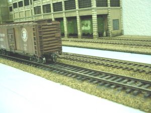

I got about 6 feet done. It was fairly easy and actually enjoyable. I changed my technique and am painting the entire side now. And as Wayne said, the paint comes off easy if you just stop every now and then and wipe it off!
Here's a pic showing the painted rail and a parallel track that is not painted. Hopefully you can see the difference!:-D

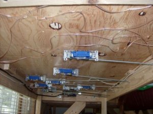

That does look good Gary. What paint are you using? Myself, I am too lazy to do all that by hand, so I will be using a spray can, Rustoleum primer brown. I have tried it before and I liked it.
And here's that picture of my wiring, please don't laugh to hard. It looks funny, but I have learned to leave some slack just in case. And if you look at the end, you will see where I hat to cut a top brace to put in a switch controller.

I used regular ol' waterbased hobby paint from the craft store. Before I painted, I took a stiff brush, dipped it in alcohol, and "scrubbed" the side of the rails. Then I took a rag and ran it along to take the alcohol off, then I let it sit for a few minutes to finish evaporating. Then I brushed the hobby paint on. It took two coats. I used several colors, tried to mix them a bit so there would be variations as I went along. Umber, Black, Brown, and dark gray are the colors I used, but mostly Umber.
Hey, the wiring looks good. My bus wires are all fancy-neat, but the rest of it is run helter-skelter all over. It is difficult to keep it really neat. And I guess, why would you need to? If the trains run, it is PERFECT, right?:-D
Hope it wasn't too much trouble cutting the brace. Can you believe with my 25 switches, not a single one ended up over a brace? I had a couple that were really close, but just missed. If that is the only one you have to cut, we'll call it good!

And cutting that brace was worth it. I am really pleased with those switch controllers. No more ugly switch machines on top of the table. And you got lucky. You having to move a brace would have been a lot worse.
