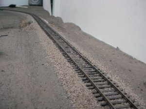

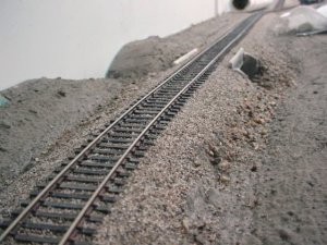

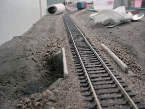

Here are some photos of more of my ballasting:

Brakie, thanks for the thoughts and the links. The pics are typical of what I am trying to achieve. I decided to do the ballast first, then I can add the weeds and stuff into the ballast edges.
