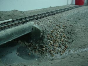

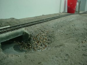

Here's a couple of shots of what I did tonight. I did manage to mess up. After I had put the thinned glue on and let it sit for awhile, I got to thinking that maybe I hadn't put on enough glue. So I decided to add more. And for some reason, the ballast floated up and got on the ties. DARN. I messed with it a little, but then decided the best thing to do is just let it dry and tenderly scrape them off lately.
Another thing I learned is that with ballast, less is better. what I mean is that ifthe ballast is deep and comes up to the top of the ties, then it is also up to the bottom of the rails, and it just didn't look good to me. I think it looks better if there is a little space between the bottom of the rail and the top of the ballast. It just looks "realer" to me.
These photos don't show much and the ballast is still wet. I also did some rocks down the ditch.
Oh.... would appreciate constructive criticism. Seriously. Help me out before i go any further, if there is something needing improvement, let's talk about it.
