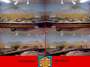

My backdrop (uncompleted) is approx 3ft 10 inch tall and is made of tempered masonite. Its about 18 feet long at present. Sorry but the battery went dead on my camera before I could snap a pic of the curved section. What's been done so far is painted with acrylics.
I thought a layout to ceiling backdrop would really be an eyecatching thing but the #%@@ thing is so big I've gotten tired of painting on it for awhile.:eek: Word to the wise...."Don't bite off more than you can chew....:D :D :D

Vic, nice pic's, post more.

Vic,
I like the mirror image of the top two photo's, great idea for a photo.

Shamus,
Thanks for the compliment...actually I was just trying to get enough pic to fill up the frame. I hate all that "dead" white space.:mad: What I should do is buy some decent software:D :D
Drawing and painting pictures is not my "forte"....but perhaps if you and Errol could provide a few liters of "Stout" then I may be encouraged to resume my "artistic endevors":D :D :D :D
