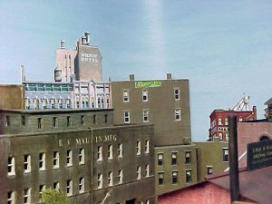

Hi Matt!
I too, wanted to try something different for my current layout...I was getting too old & tired to wrestle with those big pieces of masonite, & all the joint compound, & sanding. :rolleyes:
I used vinyl flooring this time.
I got a damaged piece at Home Depot for about $10. It was marred on the printed floor surface, but since I was goung to use the back, or under side, it made no difference. The piece I got was a remnant about 16' feet long (no seams), & 4' wide. It was easy to cut using a utility knife, & a metal yardstick as a straight edge. You will need to get some vinyl floor adhesive, & attach it to some type of wood framing.
I highly recommend it! It's lightweight, & can be bent into any shape you desire. You can paint it, glue things to it, etc...
I'm not sure how this will turn out, but here's a picture of one of the corners on my layout...I painted the backdrop blue, & used both cut out paper buildings, & plastic building flats, all glued to the vinyl.
