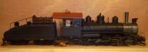

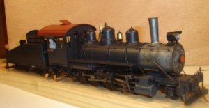

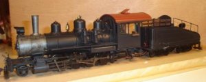

Pictures of modified OF280
I've finally got my OF 2-8-0 project to the point that it's worth photographing so I thought I'd throw some out there...
I've moved the cab back and opened it up, installed a PSC baldwin cab superdetail kit, converted it to dual air compressors with extended air tanks, installed a rear sand dome and switched to a slopeback tender. I was shooting for a baby slidevalve k-27, with additional inspiration from the white pass and yukon skagway yard/dock switcher.
So much for "it can't be done" eh? ;)
After seeing this I might just get myself one. You've made it look much better with your modifications. :) Very good job!
