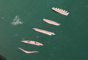

After seeing a lot threads on anime models, I am finally tempted to start one myself.:-D This is not my first model from Mizuirogakuen, but it'll definitely be the longest (5 pages, geez...)
I've printed 2 pages to a sheet as always, to save paper and ink and final size. But I soon realized that I've made 2 fatal mistakes from the start, they are going to haunt me all the way through:
1. Not downloading the newest version of Pepakura, which lead to having to print thin but clearly visible black lines on the surface.
2. Printing with a laser printer and not an inkjet, the colours just fall off when I cut them...

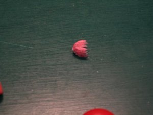

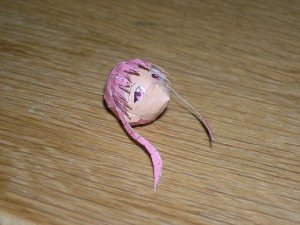

Anyway I'll make a head start, this is a success-or-fail step that determines the look of the entire model. I scrapped the original tabs and replaced the with my own, as always.

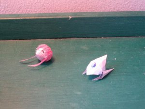

It's still termtime, so tools are severely limited in my college accomondation. I've managed to find a pair of scissors, half a bottle of office glue, a tweezer and that's it. I'll get on with that...

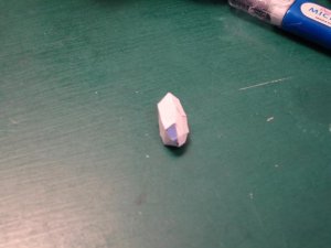

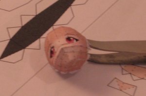

Now with most of the back hair and ears... She'll look better with forehair.

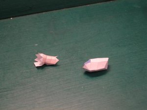

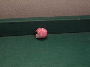

There's the forehair!
But then I found out that it was impossible to fit the last part onto the gap at the top... I must have made some inaccuracies somewhere...

Problem solved!!! Did it by overlapping the last part onto the front bit of the hair, anyway it'll be invisible once I put the helmet on. I also finished the helmet in the meantime.
As you can see clearly, black lines are due to old version of Pepakura, and white lines are due to laser printer. These degrades my expectation value from a full five down to a three...

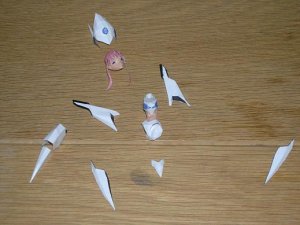

A bit more progress on the body... This android is more mecha-oriented so I could get away using existing tabs :D

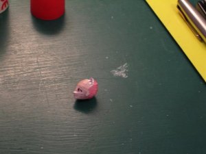

I was a bit worried about how the head will do under a repaint, but was relieved to see the result -- The lines just disappeared. And she also seemed to have undergone some tanning session :D , I didn't get the proper skin colour~

I'm a bit stuck on the hair colour for the moment -- Can someone tell me how I can get this pink hair colour from available model paints? (Because model paints normally doesn't have this colour)
R
rickstef
lots of white, and add red till you hit the shade of pink you want
It looks ever so slightly purplish. You might try a tiny spot of blue in the red/white mix.
