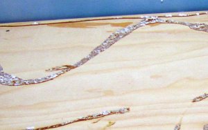

I started off with white styrofoam, but decided it was a bad choice and I've ripped it off. I used construction adhesive and it left quite a mess. I've mostly gotten the crap off, but not totally and I'm wondering how forgiving a layer of homasote would be. I'm attaching a pic of the current state of the plywood, so you can see the glue that's still there.
Any help would be appreciated.
Thanks in advance!
Val

Val, do you have access to a heat gun?? Looks like a hair dryer but blows very hot air, try this on the glued area and go at it with a paint scraper at the same time. Just heat the glue, slowly and carefully, to soften it and try scrape more of it off. Good luck.
As far as putting homasote or other type of board down,I use dona cona board as can not get homasote here on the west coast, with the glue area sticking up this will cause the homosoate to stick up if the glued area is too thick. I use one inch screws and put my top board down with that, I do not glue it down. I cut out scene areas where I put a group of buildings down, a large building scene, or do a park scene so I can work on them at the workbench when I want to, this way I can take and place them in and out when required. Makes it a little easier to do detailing etc at the workbench rather that leaning over something on the layout. I also cut some of the top board out to add coutour to the ground, low spots, ditches, swamp areas etc. , just cut it out and take it out, do not have to scrape it off the glue. Ron..
