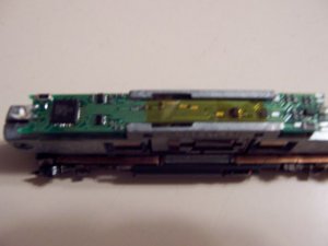

I'm getting ready to install a digitrax 163AO decoder do I need to put tape under the decoder. I've heard some say you have to so you don't let the smoke out of the decoder. Anyone install one yet?

I second what Cid said.
If the decoder is completely (!) wrapped in shrink tubing there's no need for additional insulation.
But if there is some bare metal showing (on a wire harness or even a printed circuit board), always add a piece of tape between the decoder and the (metal) frame. This should be true for any loco in any scale.

Did you have any trouble installing the decoder. I just finished 2 B23-7's with no problem. The GP-38 though is a different story. The same decoder for both locos but ht GP decoders seem to be a little to wide to let the frame meet back up after installation causing the trucks to bind. These are my first decoder installations.
