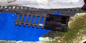

I have a pair of the Atlas bumpers and would like to use them on my layout. My problem is that im not sure what to do about the hole thats in them. The hole is about 3/16 inch small. My first thought was a red LED and have it light up, but the angle at which you can see the light is very small. Anyone else have any ideas? Its HO scale by the way.

While I must confess to having them on my N scale layout, they are not models of any prototype I know...I can't even find any close ones. On that note, your idea is as good as any, Atlas even had them with bulbs wired right off the track for awhile. My plan is to install red/green bi-color LEDs in them so that I can see the track polarity of a given spur at any time.

Lights are the simplest form of animation, I suspect that someone envisioned a yard full of red bulbs as quite a sight on the drawing board. I'll be using 3mm LEDs on mine, I figure 5mm LEDs would be right for HO, going by the ones I have in that scale.

Pretty much the same here...the added benefit of using bi-color LEDs is that you can see if you track power is set to bring them in or take them out at a glance. The reversal of polarity shows up red or green at the flip of a switch with no fancy circuitry.

how do you guys have the LED's hooked up, cause i soldered it directly to the track, but then it blew the LED. The voltage is too high, plus the LED isnt always the same brightness. It goes up the faster i move the train. I dont use DCC since its only a 4x8 layout. Maybe thats the problem? Let me know how you hooked yours up

LEDs need current limiting resistors in series with them, or they let the smoke out, as you found out. Their brightness will vary with the track voltage. You have to size the resistor for maximum track voltage, BTW. There are ways around the varying brightness bit, but some minimal electronic circuitry is required, and the LED would switch from on to off at some point as the throttle, and hence the voltage, is decreased.

:eek:ops: OOoops:eek:ops: ...forgot that part...you need more I'll send you some. Yes, I use a 1k 1/4 watt resistor, just like I do with the LEDs in my locos. And yes, they do go off at about 3 volts...not a perfect setup but cheap.
