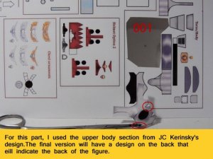

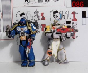

The build thread for the space marines will start shortly, here is a teaser for the the Warhammer crowd. As shown in Armormans thread, the size is about inquisitor size and leaves a lot of room for detailing and posing. I used some items from JC kerinsky's design found here.http://zealot.com/threads/armormans-warhammer-40k-models-thread.170912/page-25 It is not in the resouces at the moment but mine will be there I used especially the upper body and the weapons. There are a lot of tweaks in the build and it is build-able. The model for this thread will be that of a Space Wulf. I hope that you will all enjoy another long boring thread by me.

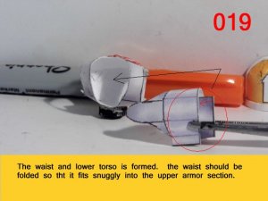

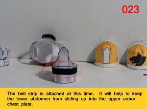

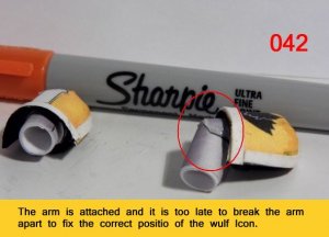

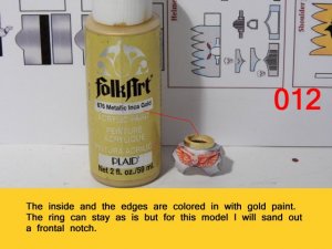

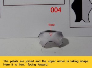

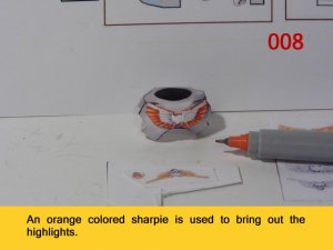

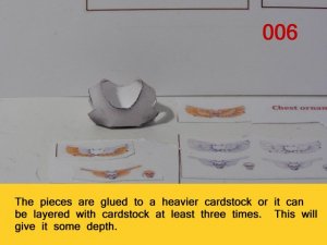

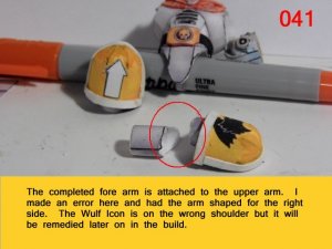

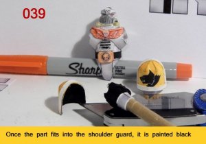

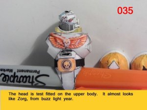

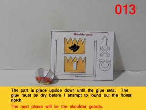

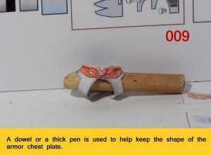

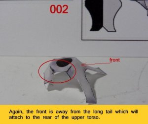

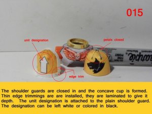

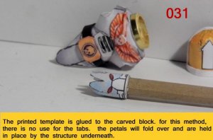

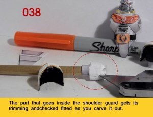

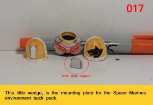

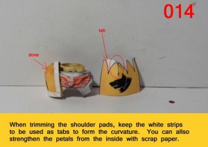

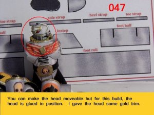

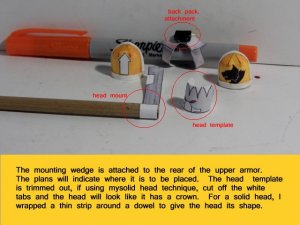

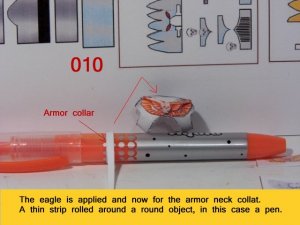

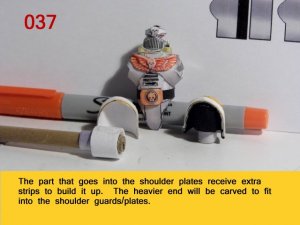

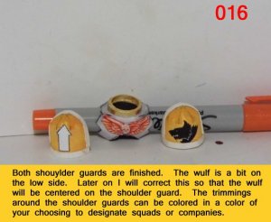

Continuing with the Space Marine. The shoulder pads are formed, the environmental support is attached. The unit designations are applied, for this marine, it is a tactical unit The arrow for this marine will eventually black but for now it is white. The wulf head is a bit low but it will be rectified later on. The waist is formed and it should fit snugly into the upper armor chest plate. I will glue mine into place but if left unglued, it can be shifted to pose the figure into different positions.

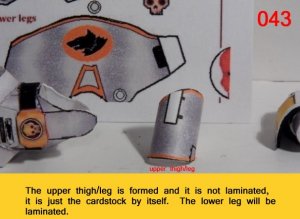

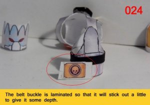

Here are some more updates on the build thread.

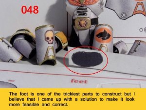

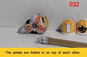

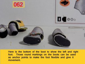

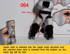

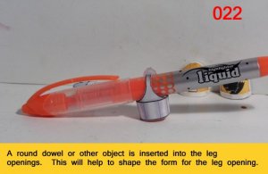

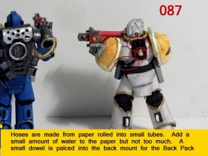

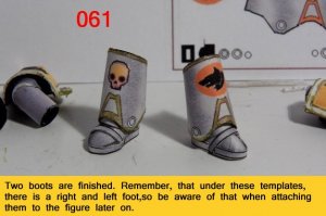

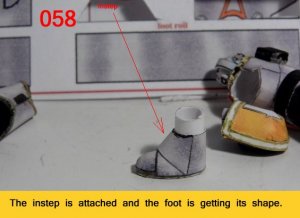

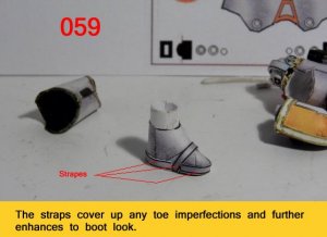

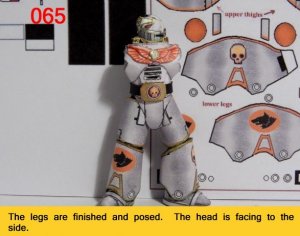

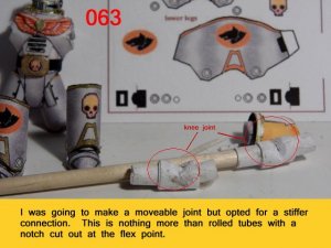

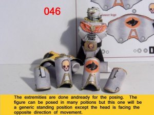

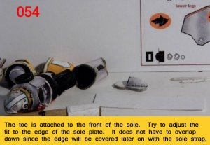

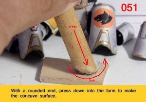

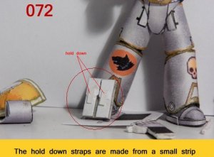

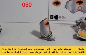

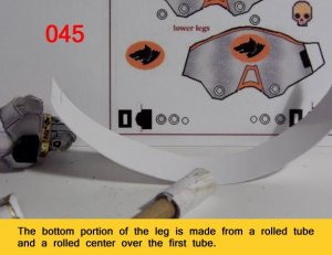

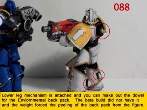

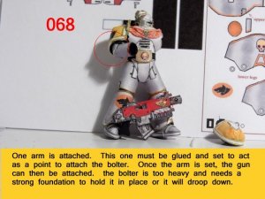

More updates on the build, the arms legs and the most tedious part of the build, the foot.

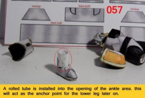

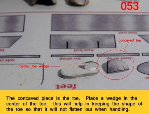

More on the build. this time it is on the foot which is more intense than the other parts, but necessary to make the illusion of a boot.

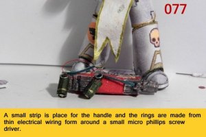

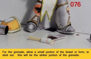

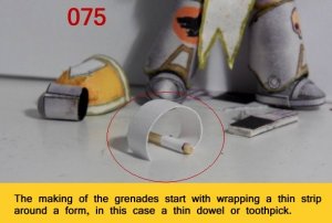

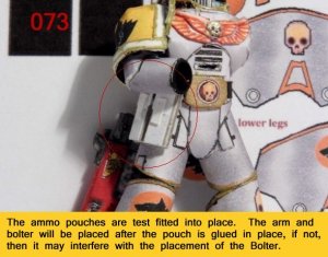

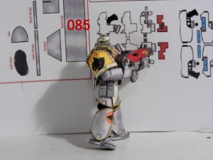

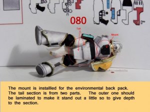

I am tied up with three grandsons and their different schedules for baseball practice and games. While I have a bunch of photos taken, it takes time to edit them for uploading, so bear with me. Here are some more updates on the build.

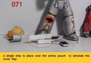

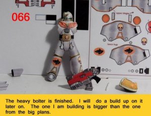

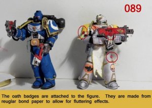

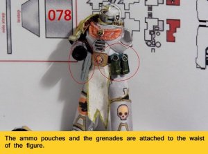

I like the grenades and ammo pouch. They gives it that extra touch that sets it apart from the rest!
Thanks. It is the details that make a model stand out.

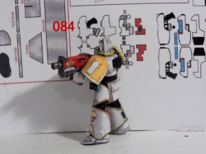

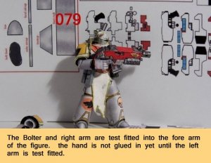

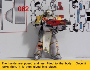

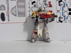

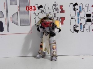

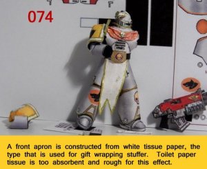

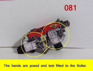

As mentioned earlier, the figure is finished but the editing will continue for a while and also some extra options to the model will be posted as well. I have three head configurations, the sword, Two environmental back packs configurations, the power chainsword, and weapons of different liveries. Enjoy and see you with some more updates.
