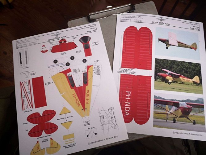

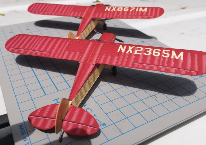

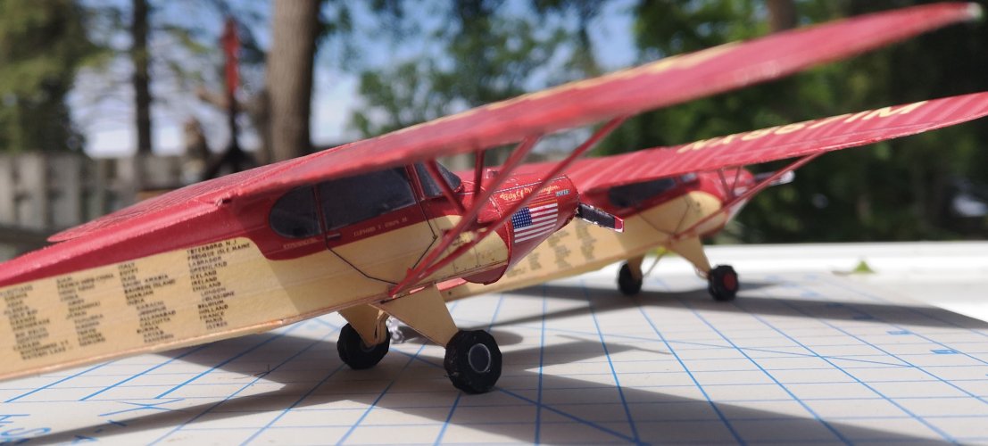

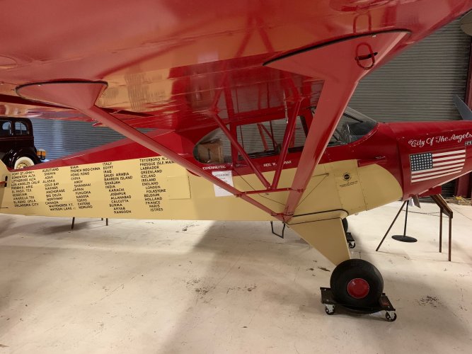

A co-worker of mine asked me if I could build a model of the plane that his neighbor had when he was a kid. He didn't know what kind of aircraft it was... I asked if he had any pictures... Turned out to be a PA-12 Super Cruiser, and so I started gathering technical data and plans. I used Piper Factory plans to create this new model.

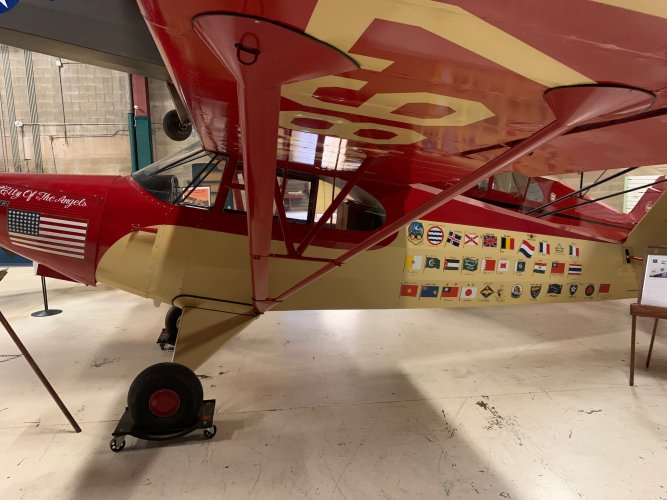

I contacted the Piper Aviation Museum about this endeavor and they were happy to take detailed pictures of 'the City of the Angels'. With that help we were able to make an accurate picture of that aircraft. While we didn't have success contacting the Smithsonian Institute to get their cooperation, we did manage to find enough pictures on-line to create an accurate model of 'the City of Washington'.
Each time the aircraft landed on their journey, they would paint the name of the place on the starboard side of the fuselages. Each time they landed in another Country, they would paint the National Flag of that Country on the port sides. These are pictures of the City of the Angels in Lock Haven, PA:IMG_4644.JPG

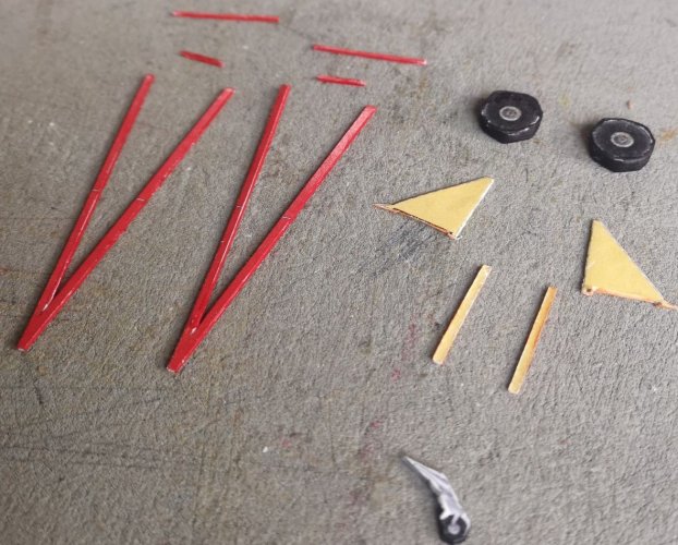

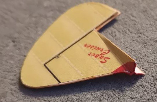

First off I make the two sided pieces. The propeller, tail wheel, and struts all have a precise rectangle drawn around them so that they can be glued precisely back to back. Set these rectangles aside to dry thoroughly. The tires for the main landing gear gets glued to cereal box cardboard at this point.

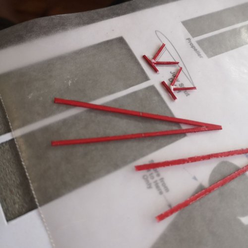

Now the landing gear and wing struts.
the jury struts are peculiar to the PA-12. There is a detail on the model sheet that shows what the jury struts look like. I place a piece of waxed paper over the detail and glue the jury strut assembly to the waxed paper. When the glue is dry, I can peel it off the waxed paper.
Landing gear struts glued on - when they are dry I glue on the wheels.
And finally the wing struts
