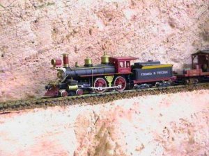

My last layout, the Ferkel Lines RR is made from this great stuff. After the final shape I applied few layers of plaster mixed with about 50% white glue and water.
The foam works for long time, so for my wild west scenery I have got lot of cracks etc in the surface which enhanced dramatically the overall view.
More pictures are here:
FLRR

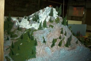

I made a rather large one over a year ago. It's made of low expansion foam on a wire and tape core. I'll list the pluses and minuses. PLUS, very light and easy to put trees into and to carve with a knife. MINUS, rather expensive as four cans went into a 3 foot tall by 3 foot around mountain. Hard to control and work with. Very sticky when sprayed, fingers were nasty for a week. Easy to cover uncut parts with paint, but cut areas soak up paint worse than anything I seen, took almost 2 gallons of latex housepaint to get it covered. Worse thing is it's disappearing slowly. Notice yellow patches in picture that were once covered with paint but are now flaking off. Let's put it this way, the last mountain I just built I used papertowel hardshell on a wire and tape frame. DASH10
