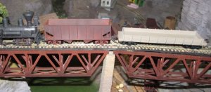

I have some unfinished tichey hoppers and gons on my Rr for testing, they are too light for my current mountain division, I'm planning a rebuild with gentler grades and wider curvs, so they may work unmodified on my hoped for future RR.
the hopper cars, I had a six pack of, I don't have a lot of the details on yet, as everything is scale profile, thus fragile. I have a lot of hand rails to install, as well as the lettering to do, which will be tedious for a private road

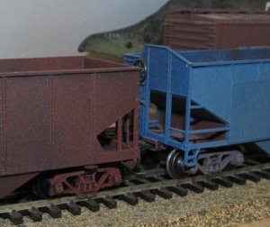

another picture is one of the unfinished Tichy hoppers (Black) with a shake the box hopper.

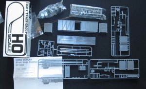

the last photo is a picture of the parts for a Boxcar kit, the phosphor bronze wire is to bend to shape to make the trainline brake piping.
