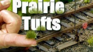

Hi everyone. I'm new to this forum but have been looking around for a while. So I'm going to start off with a question. In a lot of the Silflor adds, I see a photo which has a switch stand connected to the throw bar with piping and a 90° linkage.
http://www.sceneryexpress.com/products.asp?dept=1056
Anybody know who makes this? I would like to use operable piping to operate a derail connected to a switch.

Thanks. They've got some really nice switch stands (some of which I'll undoubtedly purchase in the future). What caught my eye in the Silflor ad, though, was not so much the actual switch stand as it's the linkage. Maybe its something that could be scratchbuilt from brass sheet and music wire.

Maybe I'll just write a letter to Silflor asking if they know. They may have contracted out the model, but it's worth a shot. Of course, I'll have to find somebody to translate my writing into German.

there's no use to write to Germany. Right, Silflor is a German manufacturer of scenery material, but they prduce only turf, grass, bushes and trees. They don't carry switchstands or other track details.
Apart from that, European switchstands are looking completely different from the American ones. (That's why I have to import MY switchstands from the USA! :D :D :D )
My educated guess is, that Scenic Express handbuilt one superdetailed turnout and then dotted it with the Silflor pariries grass tufts. If the hand shown in the pic isn't copied in separately, I think that this turnout is modeled in 0 gauge at the least, if not bigger. BTW, those Silflor landscape products really look fantastic.
I enlarged the pic from the ad - have a look at it: At least now you can study the mechanics of the switchstand a little better. It's ingenious! Perhaps it is a commercial product - better ask Scenic Express.

Ron,
