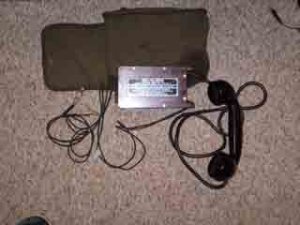

Brakie I am sure you will be able to ID this for me but if not anybody else wanna give it a try I bought it from a guy that said it was a RR telephone?? but trying to figure out what it is and how it works????
I am thinking from the OD green bag it came in it might be military issue but I have no idea the label on the top reads
Model 4565 uniphone
portable telephone set
Western Railroad supply Co. Chicago 8
Remove this side for inspection or service
Remove left end to renew batteries
and it uses 2 d batteries and has aligator clips on the ends of the two wires coming out of the one side and the hand held has a push to talk buttonlooks to never have been used altho the hand held wires inside the box have been pulled loose so I will have to find someone that works with old wires that can fix it because I have never seen anything like the stuff that these wires are made from..
so anybody know what I got for my ten dollars and what it is for give me a shout and thanks for the help

A picture would help, but from your description it sounds like a rather old signal maintainers portable telephone set, a railroad version of a telephone lineman's handset.

That sounds like a portable phone they would use at train wrecks and other construction sites..This was used so the assistant road foreman could keep in touch with the tower operators or dispatcher.You see 2 ARF would dispatch trains through the derailment or track construction site.There would be a ARF on both ends.There may have been a temporary crossover installed so the trains could use the other main. Of course a shoo fly track could be used as well..
That is a telephone. I saw one on Ebay a few years ago that was used on the Rock Island. All you do is clip 2 wires to the pole and you are in business. Radios back then were very large and used alot of power. For the most part they sent CW (Morse Code) A friend of mine, who got me into Ham Radio, has the military version of these. They are pretty cool. His son Chris and I played with them in our childhood

Looks a bit like what phone phreaks call a "beige box" or lineman's handset: clip the clips to a phoneline and use the built-in dial to make a call. I assume this is even simpler, with only a direct line to speak to the dispatcher.
