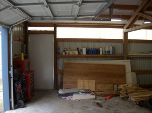

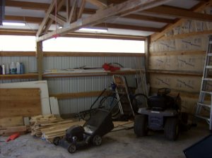

Thanks Russ, that is what I was wondering. And, if you look at the pics I posted, there is a 2x8 running along the center of the walls that I will have to trim down to 2x4. Looks this will keep me busy for a while.

Why do you have to trim the 2x8? In the pics it looks like it is mounted flat against the wall. You should be able to just screw your 2x4 right to the 2x8 and use it to help support the stud wall.

Russ, if you look again, there is what looks like a shelf along the middle of the wall. It's a 2x8 on edge. It sticks out about an 2" when I hold a 2x4 against the wall.

I just looked, I didn't notice the "shelf" until I saw what looks like an extension cord laying on it. Don't try to cut it down to match the 2x8s that are mounted against the wall. Put a 2x4 leg under each end for support, and cut it @ 3 1/2 inches out from the 2x8s. Then you set your blade depth on your circular saw to cut notches the depth of the 2x4 studs where ever the studs go. When you set up your stud wall into place, run screws into the studs from the cut down 2x8 at an angle and it will act as a stiffener for the studs as well as a fire break.

Do you mean I should notch the 2x8 to fit the studs? I am having trouble visualizing what you mean.
Loren
The other 2x8's are mounted to the wall on edge. That means they stick out from the wall 1 1/2 inches. If you try to trim the 2x8 shelf down to the same thickness as the other 2x8's, you will end up with a 2x2. If you cut it length wise to leave a 2 x 4 sideways against the wall and try to mount studs against it , they will not be flush against the other lumber on the wall. What you want to do then is notch the now 2x4 board for each stud to allow the studs to be screwed flush to all of the lumber on the wall.

I hadn't thought of 2x6 studs, but it might be less work. In that case you would need to cut 5 1/2 inch x 1 1/2 inch notches on 16 inch centers in the 2 x 8 shelf. You could put some really thick fiberglass bats in for insulation as well.

That 2"x8" is either a lateral stiffener for the wall, or it's a shelf. If it's a shelf, simply remove any of it that's in your way. If it's a stiffener, don't notch it at all, as its strength will be compromised (the same reason why you can't notch the bottom edge of a joist). If the latter is the case, simply build your 2"x4" stud wall inside the inside edge of the 2"x8". Tie the new wall to the 2"x8", and, if you're going to add insulation, block the space at the top and inside edge between the new wall and the existing exterior wall. Use a Hilti gun to fasten your bottom plate to the concrete floor.
Alternatively, you could build a 2"x4" knee wall below that 2"x8", using it as the top plate, then build a short wall to set atop the now-supported 2"x8". Make the inside face of your 2"x4" wall flush with the inside edge of the 2"x8", and again, Hilti the bottom plate to the floor.
Edit: After looking at your photos again, and re-reading what I've written, I'm convinced that those 2"x8"s are stiffeners (they seem to be on all of the walls), so I would neither notch nor remove them. I think that my second suggestion is your easiest and cheapest solution, too, and would give you an extra 3 1/2" of floorspace. ;):-D

You are talking about building a wall on top of the "shelf" and a separate wall underneath the "shelf"? That is what I have planned on doing with the 2x6's. I would use joist brackets to fasten the studs to the 2x8's top and bottom. That will give me a flush surface to drywall. I just got back from HD to see what's available, which is what gave me the idea.

Loren, the joist hangers are superfluous in this situation, as you'll still need to toe-nail the studs into the 2"x8". Your other choice is to build two short (height-wise) walls, with both top and bottom plates (although the bottom one could use the 2"x8" as its top plate), with the nails driven through before installing the top section. The lower section would fit under and support the 2"x8", while the upper one would merely sit atop the now-supported 2"x8".

You've lost me there: the new lower wall section, without a top plate, would be built laying on the floor, then placed under the 2"x8". Fasten the bottom plate to the concrete floor with Hilti nails, and nail down, through the 2"x8" and into the top end of the short studs used for the lower wall.
Construct the upper wall section, again, on the floor, using both a top and bottom plate. Lift it into position atop the 2"x8", then nail down again, through the bottom plate and into the 2"x8". You'd need to tie the top of the upper wall section to the main wall of the building, using blocks of wood and nails or screws of the proper length. Are you intending to cover over the window area at the top of the side wall? I purposely built my basement layout room with no windows, as I wanted to have complete control over the lighting, although that's a matter of personal preference. A fully insulated wall, instead of the window area, will make it easier to control the temperature in your layout area, though.

If you look at the pics on page two, there is a 2x6 running above the windows. I was going to fasten the wall studs up to them for strength, but not build the room any higher than the truss. So yes, I would cover the windows with insulation.
As far as the ceiling goes, I thought I could build it like the walls, and maybe fasten it to the truss for support? The ceiling would be flat.

I would plan any ceiling joists to be supported by the stud wall in back, on both sides, and the front. The trusses are designed specifically to support the roof and any snow load that might end up on the roof. I wouldn't try to use the trusses to support anything else. You are going to use stud walls to create a 9' x 20' room for the layout. Run your ceiling joices in the 9 foot direction, and you won't need to use outrageously heavy lumber to span a 20 foot distance.
