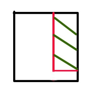

Is there any way to add a regular door (Man door) to the side of the garage??? Also - I think Russ is on the right track here.. we need more information!!! :D :D :D
For example.. Leave the "Left" side of the garage for the car, close off the right side for the trains..
I have a 10 X 10 workroom, which is a converted garage. the 10' door isn't really insulated. I use 1 electric ceramic heater... It takes about 10 minutes to heat the room. If you get 2 of them you should be fine. ALL newer models have a tip switch, when they start to tilt (10 - 15 degrees) like when I knock it over :D It shuts off immediately! The insurance company recommends them....
Only other thing you have to decide, is how big to make the area and where to put the door. And remember - you can have the door open "in" toward the trains or "out" toward the garage door or the car.....

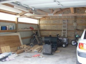

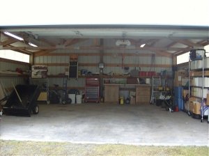

Here's a couple of pics of what I have to work with.
The area on the left is where the trains will need to be. There is a man door in the near left corner where that door is leaning up. I figure I can go 20' on the left wall, and out to that center beam, about 11'. The garage door track is 7' from the floor, so I think I could put a ceiling underneath the track and then raise the ceiling beyond that so it's not so cramped in there. What do you think?

If your door goes up into a track that is 7 feet above the floor, you could install a stud wall right behind the garage door and a lower ceiling below the track with the ceiling going higher just past the end of the track. If you use a pocket door in the wall for access to the train room you won't have it swinging into the car or the layout space. I think you could possibly get a layout room 12' x 23' in that area!

If the door tracks are at 7 feet, he would end up with a ceiling height at the door end of 6 feet-6.5 feet. That isn't too bad if he is under 6 feet tall. If he is 6 feet tall or over, he might want to pad that part of the ceiling with foam rubber.

Thanks for all the replies. After due consideration ( and a lot of measuring and thinking ) I am going to wall off the back of the garage. That will give me a 24 'x 8' area that will be 7' high. And leave me some of the shop area to park the yard tractor and stuff.

The picture look like your back wall has some boards going across the wall. You can use 3 inch deck screws (won't rust) drilled through studs at an angle and into the boards to hold the studs in place.
