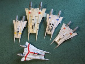

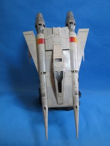

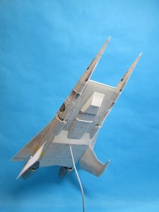

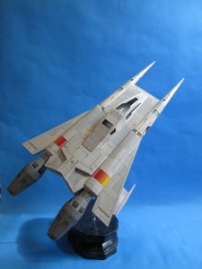

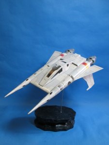

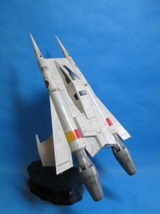

Hello All! I finally finished this and thought you might like to see some pics. I really love this kit, it's my absolute favorite Sci-Fi ship. This one was meant to be a fun quick build, as I haven't finished much this year, but next time, I'm going to build it with the interior and a pilot figure. Because, you can never have enough Thunderfighters (or Vipers!) in your collection! The red and white BSG version in the last pic is the Monogram kit inspired by the one done around here a while ago, even though it's plastic, I thought it would be fun to include. Enjoy!
