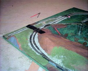

Ah, found the cable and the disk. Now I can post a few pix of the work so far on Moe Hill.
Here is the first, looking through the NSR cut through.
Michael

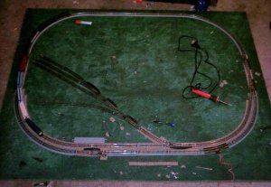

I might add, you can add ballast to all areas around the moving parts, as long as you don't excede the height of the ties, except the area colored red. That area will be cleaned up by following Tysons fool proof method of ballasting a turnout.
If you want a portable to look good, you about have to glue the ballast everywhere. I would think using glue and vaccuming off the excess around the turnouts would increase reliability even on a stationary layout. :rolleyes: :rolleyes: :rolleyes:
