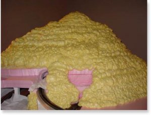

I now know what 8 cans of Great Stuff! foam can do for a mountain.

I extended the trolley level into the mountain. Amazing what a hole saw does to foam. And what a mess to clean up. Thankfully it's all contained in the living room. :D

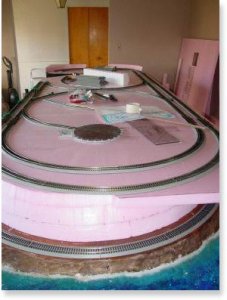

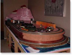

OK, here are some pics. At least some of the ones that downloaded from the camera before the computer lost its mind.
The first one is a shot of one of my helpers. Not all that helpful though and her fur likes to get in the wheels of engines going by on the tracks when she doesn't move her tail quick enough. Needless to say, she not allowed on the layout anymore.

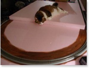

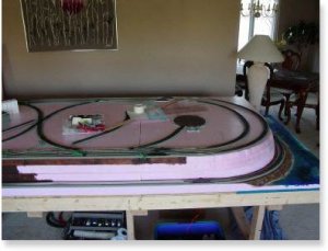

Adding more layers of foam. Overall the main layer is elevated by 3 layers of foam. 2 2" thick layers and 1 1/2" thick layer.

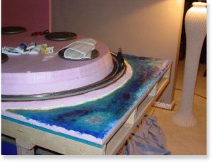

Here is the lake full painted. I'm holding off on adding "water" so I can integrate a lighthouse to the lake in the far back corner.

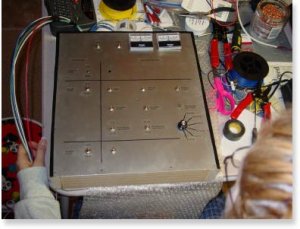

Here I am hard at work on the control panel wiring. Even Mr. Mac was impressed I could do all the wiring without his help.
