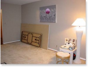

The new HO layout.

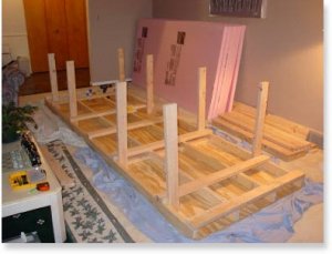

Here is the corner of the living room (yes, it's in our living room) before the improvement. The plywood and table against the wall are leftovers from my old layout.

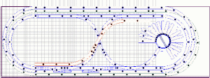

Here is the overall layout plan.
The outer greenish loop is the lower loop. The blue is the main loop which is 5 1/2" above the lower. The red is the trolly level which is 3 3/4" above the main loops.

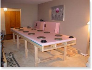

Mrs. Mac:

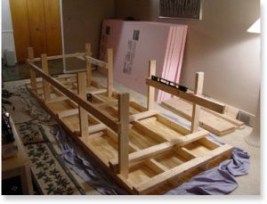

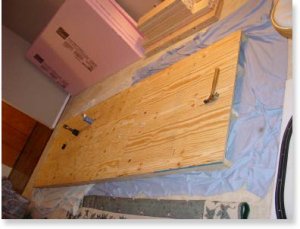

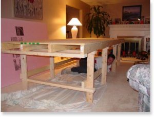

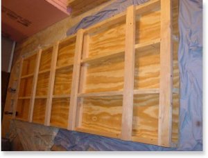

That is outstanding work. I love the design of your benchwork! It looks like you'll have some nice storage space under the layout too! I notice that you seem to have "Mr. Mac" stored under there in the 6th photo. ;) Will you have sufficient access to the back of the layout? I would be sure to leave at least some space between the wall and the rear portion of the layout for track cleaning and re-railing equipment.
You are off to a great start! Keep us posted as to your progress. We never get tired of progress photos.
Eric

That is some sturdy and well built benchwork! Nice carpentry! You're going to make the layout a piece of your livingroom? Cool! I take it from your track plan that you most enjoy long continous runs, two train operation and probably have a large collection of locomotives (?). Looking forward to updates!

Looks real strong! I made benchwork similar to that in my garage... you could literally body tackle it and it won't budge. Great for avoiding derailments from the casual passer-by. :D

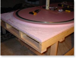

I got the lower loop of track laid, and about 1/2 of the upper loops. I have to visit my LHS for some more track and stuff before I can finish. All that time waiting for the liquid nails to dry gave me alot of time to start painting the lake and the river/waterfall areas.

Let's see. Since my last post, I'm completed laying the main line and trolly levels. Yeah!!! I'm working on the wiring and control panel now. The layout is functional with the exception on the 2 reversing loops. Can't power those until my control panel is done.

pomperaugrr, The layout will be about a hand width or so from the wall to allow access for derailments and cleaning.
