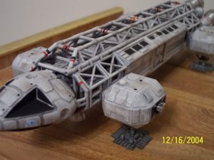

AMT's Eagle 1 from Space 1999
micahrogers
Jul 12, 2012
3,134
3,513
Shannon GA

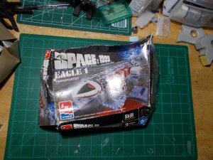

I was in the shed going thru the stash of plastic kits wondering what to do next and this crumpled old box was starring at me all the time. After about 10 minutes of searching I looked again and said "allrighty then"
This is what the top of the box looked like after I got it inside.
as you can see it got quite mangled in the years it's been in storage.

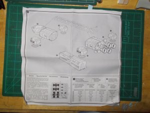

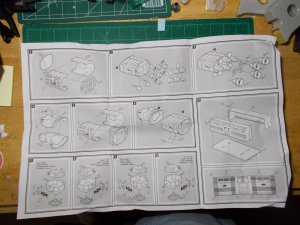

The instructions are intact

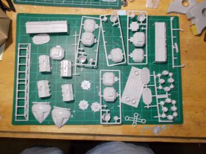

And the parts in the box all laid out.
but alas it's not 100% intact...
one part got broken in half.
so I'll try gluing the broken part back together.
I'll take plenty of pics and keep Y'all updated.

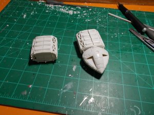

A mid day update.

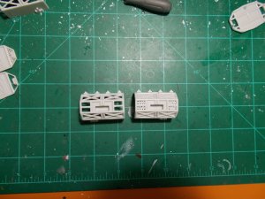

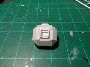

I have all the panels that will be removed defined by drilling 0.5mm holes, about 300 or so.
I'm working now on removing the panels.

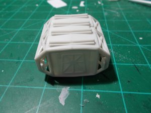

Here are a couple before and after pics.
The front control pod has the cockpit windows removed .
and the pod exteriors.
and the interconnecting door panels.
More updates to come

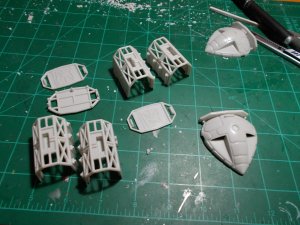

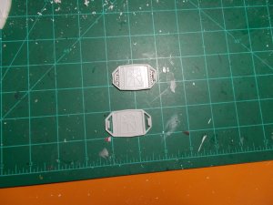

And the Plastic Surgery is done,
I still have some clean up to do, but all things considered, I happy with these results.
and a couple pics of the pieces just stuck together to give an idea of how it's gonna look.

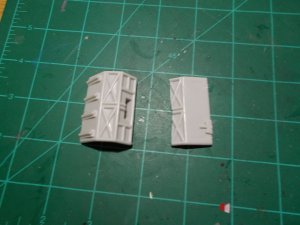

I' decided to open more areas of the cage structure , I found this pic on the net
which shows the opening behind the command pod, so I opened this area up.
And here is a shot of that ghastly seam that I found and filled.
so this is the state it sits in as of now...
more updates to come.

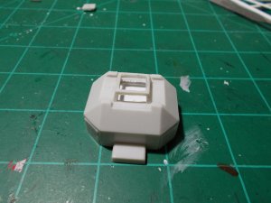

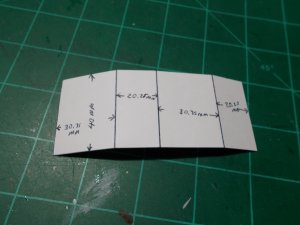

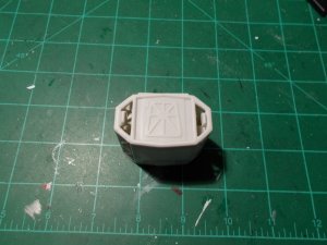

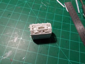

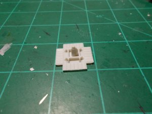

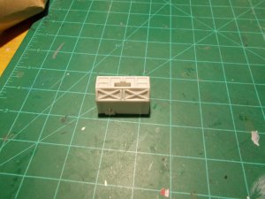

Okay, it's official, I've designed my first Paper model part :D
alright so it's a box, but it's measured then drawn then cut and folded, then ARgghhh :banghead: I forgot to take paper thickness into account.
so redraw cut fold and Razza Frazzin, :banghead::banghead: I forgot the line thickness...
then finally a finished part
and a final test fit,
this will work, and for mcusanelli if you want the part for your build it's 20.25mm tall by 30.75mm wide by 40mm long and the lines were drawn with a 1.0mm pen.

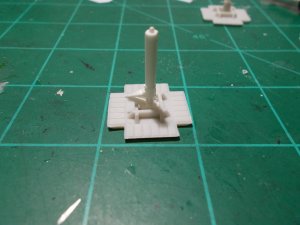

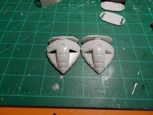

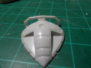

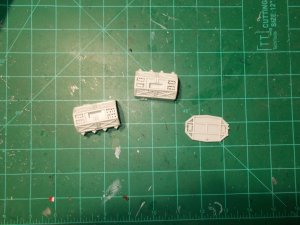

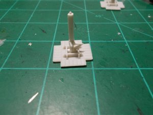

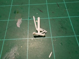

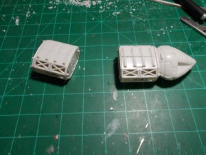

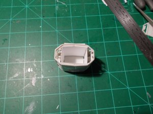

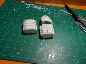

Onward and downward at this stage of the build. work commences on the landing gear.
I found this pic on the internet which shows the landing gear rather well.
so here is the modifications to the kit parts. It starts out looking like this, Eagle_023.JPG some minor surgery and a donor part that looks like this,Eagle_026.JPG Eagle_027.JPG make a new part that looks like this. Eagle_024.JPG Eagle_025.JPG

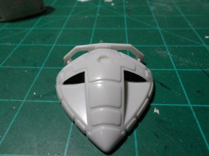

Now to repeat this three more times.
