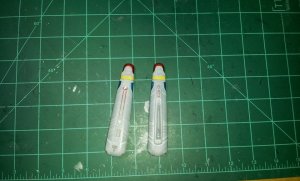

My latest update on my PL 1:2500th Enterprise D from TNG. Base coat of Vallejo Pale Blue Grey, Detail call outs of Vallejo Flat Yellow, Neutral Grey, Intermediate blue, and Tamiya IJN Grey.20140323_181503.jpg 20140323_181530.jpg

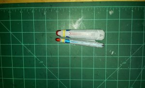

Well, the long Strange trip begins. The first four (4) decals applied to the top of the nacelles on my 1:2500th E-D1609582_673747902685517_1752113680_n.jpg

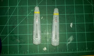

Update on my 1:2500th E-D, 10 more decals applied to the nacelles, a total of 26 so far. The dull coat has been applied to the nacelles and the two step finish for the lighted effect is done, Tamiya clear blue, and clear red.10155859_676951689031805_169081789_n.jpg 10247451_676951669031807_1075974580_n.jpg

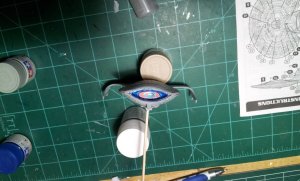

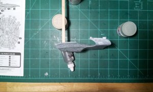

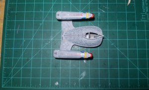

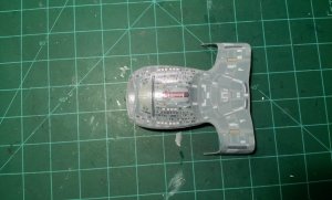

A composite update of this weeks progress on my E-D.
The topside of the secondary hull received 4 base layer decals and 3 second layer decals.
The bottom side of the secondary hull got 3 base layer decals and 5 top layer decals.
Then the secondary hull was flat coated and the deflector dish was painted to simulate the lighted affect.
That brings the running total of decals up to 41. Next will be the primary hull and dorsal.

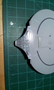

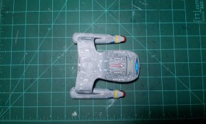

The Aztec decals are the base layer, they are left to fully dry then a spot of gloss coat over the location of the top layer decals, once the gloss coat dries then you can apply the top layer decal. 1781184_681518128575161_4844950665594362449_o.jpg
In this pic the base layer decal is circled in blue and the top layer decals are circled in red.

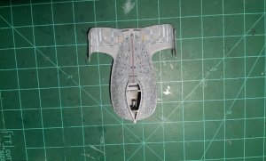

A short update for today, six base layer decals applied to the underside of the interconnecting dorsal.
For Revell Fan, the three decals still on the paper backing are the top layer detail decals for this section of the ship.
The total of decals applied is now 47 for those keeping count.

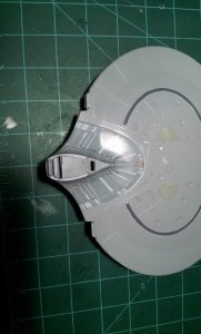

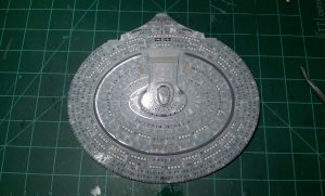

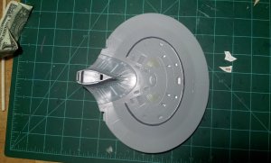

and my day off update :)
In this small scale the interconnecting dorsal is molded with the saucer, so I got the dorsal decal-ed,
And nine on bottom,
and then got the base layer decals applied to the top of the saucer. eleven in all
so 25 more decals applied today, for a total so far of 66 so far.
Next will be the underside of the saucer, then final top layer decals

WOOOW! This is a lot of work but it is worth it. I like the idea to skip the (daunting) masking and airbrushing process and to do everything with decals. The result is very clean and you don't have to clean your equipment at the end of the day.

Thanks Revell-Fan, off sick today ugh.... but using the extra day off to try and finish up the project.
